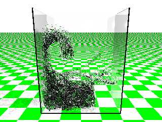

i got a trianglar mesh file, and i render it with the "mesh2" object, the
result can be seen in the attachment. But there so many black holes in the
image.
in my mesh file, there are three data blocks: vertices, normals, and
triangles' vertex indices. I am sure that the vertices and the trianlges'
vertex indices are absolutely right, so i think maybe there are two
possible reasons for the unwanted black holes: 1,there are many uncorrect
normals; 2,there are many missing triangles on the mesh.
For the reason 2, i have not any idea about how to make it. and for the
reason 1, i have already reconstruct all the normals totally based on the
vertices and the triangular topology, but there are still many black holes.
so now, i think that maybe pov-ray ITSELF can get rid of(or alleviate) the
black hole problem EVEN with missing triangles. the rendering code i use is
as
follows:
object{
  TriangleObjMesh  // water surface mesh object
  material {
  texture {
    pigment {color rgbt <1, 1, 1, 0.85>}
    finish {
      ambient 0.0
      diffuse 0.0
      reflection {0.0, 1.0}
      specular 1.5
      roughness 0.003
  interior {ior 1.333}
IS there anybody can give me some advice??
Just a quick question to make sure it's not the obvious:
What max_trace_level setting do you use? Do you get any warnings about
it? A max_trace_level which is too low will lead to black spots when
used with reflection and or refraction.
Could be very well, though, that your problem has a completely different
   source.
HTH,
Florian

From: Kenneth
Subject: Re: seek for help about rendering water surface
Date: 22 Mar 2006 02:40:00
Message: <web.4420fe62b0f87641ca0aec440@news.povray.org>
> image.
Just a guess, but could it have something to do with your REFLECTION values?
You have reflection {0.0, 1.0} as the min and max values.  The POV docs say,
"The minimum value is how reflective the surface will be when viewed from a
direction parallel to its normal..."  Here, the min value is 0...meaning
black (?) or no light reflection at all (?). Again, I'm just guessing, as I
haven't had occasion to use "minimum reflection" before, so I don't really
know *how* it works.
Ken
From: lien0n
Date: 22 Mar 2006 03:05:00
Message: <web.44210520b0f87641598059850@news.povray.org>
i turned it to 0.5, and the result is much better~
