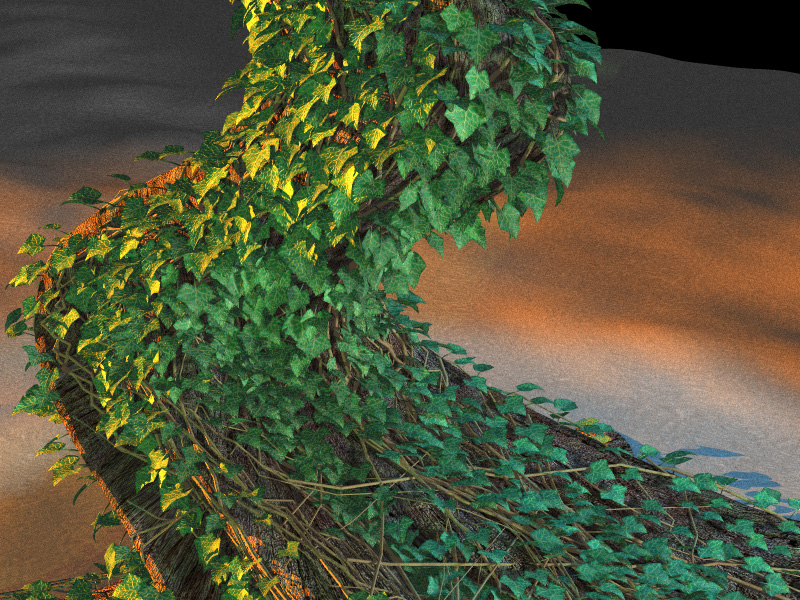

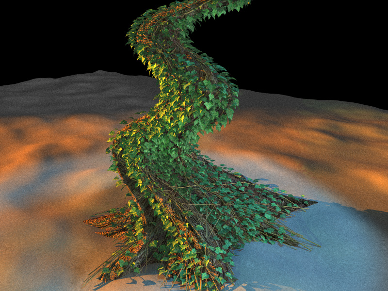

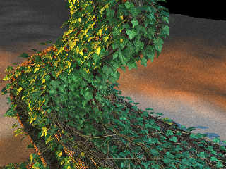

Hi, all!
My first post at p.b.i.
A rather complex, multi-TRACE experiment, using #while loops of course, with
LOTS of conditional #if's and rand calls.  And, for the ivy leaves, that
magical Point_At_Trans macro, in transforms.inc.
I purposely didn't make use of any of the tree or hair-making macros
available (or look at their code), as I wanted to see what I could come up
with by myself.  The trial-and-error method!
The point of this was to create a wildly-curving object (the tree, an sPatch
model) and have the trace operations accurately follow its shape no matter
where.
Right now, the ivy isn't actually attached to the vines--but there are so
many leaves to hide that fact, *hopefully* it's not apparent.
Each vine is a union of short cylinders. (No "branching" yet.) I tried
sphere_sweeps for the vines, using the cubic_spline type, but the result
looked like I had sprayed the tree with Silly String. Too curvy. (I suppose
I could try another spline type, with more control points, and massage
their values, but it was difficult enough, code-wise, dealing with just a
cubic spline!) And sphere_sweeps take a *long* time to render. Besides, I
kind of like the sharper "angular" look of the cylinders. Oh, and I
purposely made the bottom of the vines come out of the ground and "reach"
for the tree--as if they are slowly, inexorably pulling the poor tree down
into Mother Earth. (On my to-do list is attaching ivy directly to those
cylinders.)
Hope you like it!
Ken
Download 'ivy_tree_1.jpg' (247 KB)
Preview of image 'ivy_tree_1.jpg'

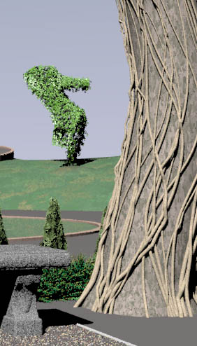

And here's a close-up...
Download 'ivy_tree_2.jpg' (370 KB)
Preview of image 'ivy_tree_2.jpg'
Subject: Re: ivy on a tree WIP
Date: 19 Jan 2006 03:22:42
Message: <43cf4c52@news.povray.org>
"Kenneth" <kdw### [at] earthlinknet> schreef in bericht
news:web.43cf4224238f31cedbcfc3c90@news.povray.org...
Excellent work, Kenneth! Congratulations!
I don't care about the cylinders, although in the close-up, they are perhaps
a little bit too conspicuous/artificial. In any case, i like it!
From: Kenneth

Thanks; much appreciated.
Yeah, I agree. My aim is to find some kind of shape that's "inbetween"
strickly angular and strickly Silly String.May yet have to use a
sphere_sweep, with more complicated control of its points. What a
daunting task.
Ken

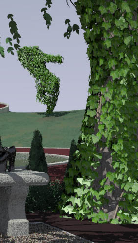

Kenneth wrote:
Excellent work, and a subject close to my own heart, so I can doubly
appreciate your efforts.
Some test renders from one of my many wip's
Download 'detail1.jpg' (52 KB) Download 'detail2.jpg' (50 KB)
Preview of image 'detail1.jpg'
Preview of image 'detail2.jpg'

> That is truly excellent. Very realistic. I agree that the vines look a
> little too angular near the base, but I think they look fine further up.
> Did you make the leaves yourself too?
Yes, as a single sPatch model, painted with a (rather simplified) Photoshop
artwork overlay, based on some photos I took.  Luckily for me, right
outside my apartment window is a gigantic old gnarly tree, practically
engulphed in ivy half-way up its trunk. So I had daily inspiration!
> The straight-line approach... perhaps you could join the cylinders with
> torus segments?
A very neat idea, I'll have to try that.  At one point, I was considering
using half a torus to try and recreate where vines actually cross over each
other... the "bump."  But I concluded it would have involved a rather major
re-write of my tracing code...at the very least!
> Just out of interest, what sort of parse time vs render time are you looking
> at?
I should have made a note of that, but didn't. Total render time (using
cylinders for vines) was between 3 and 4 hours on my 400MHZ  Pentium II,
using AA 0.2.  Parse time was a small fraction of that--perhaps 5-to-10
minutes at most. I actually aborted the sphere_sweep render about half-way
through! But I'll run that version again and report back (the code is still
intact.)
Ken
