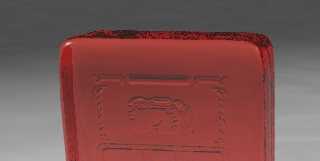

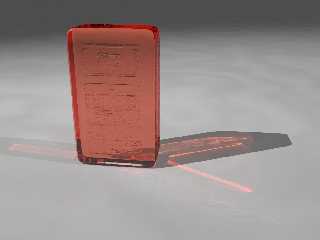

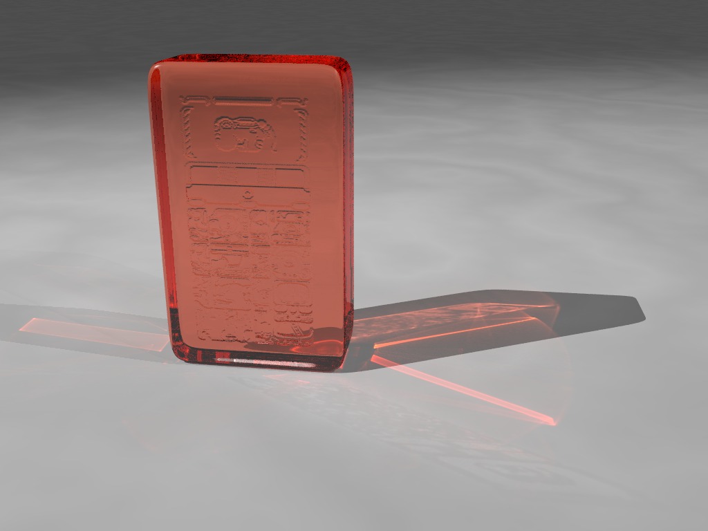

Hi all !
A Mayan stela with the date glyphs of Dec-21-2005.
Any idea how to get rid of the silly dots on top of the stela?
It is an isosurface with function f_superellipsoid. But these dots also turn
up when using a real superelli of the same size and material.
Find the code at povray.binaries.scene-files with the same subject name.
Comments welcome!
Yours,
Bu.
Download 'stela.jpg' (71 KB)
Preview of image 'stela.jpg'

I have not checked your code, but perhaps you could try moving the glass
block upwards very slightly, to make sure there is not a coincident surface
at the bottom. This could cause the strange dots you see at the top.
But if there is no coincident surface down there, then I am just rambling
for no apparent reason. =P
I like your picture though, very neat. Only thing I could suggest is perhaps
to get the glyphs to stand out a bit more.

I tried to follow etrask's idea and moved the stella a little upward, but
it still persist. I also tried to reduce the accuracy of the
isosurface down to 0.00001, but still the same. I also tried to put a white
plane above the whole scene in case it would come from reflection of the
black sky ...
I just notice that the bottom of the stella renders quite dark.
Maybe someone else can help you. Could it be a numerical artifact (things go
better with a box instead of superllipsoid-like shape)? Anyway, I wonder
why this undesirable effect...
Regards.
    Bruno.

Thank you etrask and Bruno, David and Roman.
Before I read Bruno's post I already tested etrask's proposal and gave the
stela a translate 0.002 * y (1/1000 of its height). That already removed
most of the dots.
The carving should really a bit deeper. I have to balance the depth of the
carving with the refraction of the light in the shadow to the right.
Didn't try the accuracy trick as I feared the rendering time. BTW Bruno, you
must have spend a real long time with it, hope you didn't do it all with
photons...
The dark part at the bottom of the stela I think comes from the large ior.
Value is 1.765 - that of corundum (or of ruby what I just found out) ,
somewhere in between of glass and diamond. I will also try a lower value,
say that of emerald ( 1.575, ok emerald is hardly ever red but we're all
flexible aren't we).

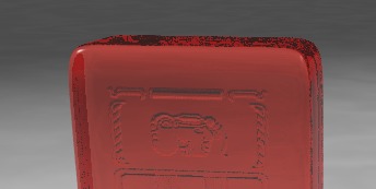

I stripped the problem down to a fairly minimal scene, to eliminate
anything to do with isosurface parameters, coincident surfaces, photon
artefacts, etc. and the dots are still there.
My guess is that they might possibly be real effects. The particular
shape of the superellipsoid causing infinite internal reflections.
If you set the max_trace_level to 100000, then there are fewer dots, and
the ones that are left turn red. That suggests to me that some rays are
getting trapped forever inside the object, becoming slightly redder with
each internal reflection.
I also assume that this must be the case (I am unable to do any further
checks here at work, when I try to DL the source it gets corruped.  I'll
have to check later at home).
BTW I believe that max_trace_level can be maximum 256:
3.3.3.7  Max_Trace_Level
Values for max_trace_level can be set up to a maximum of 256. If there is no
max_trace_level set and during rendering the default value is reached, a
warning is issued
-tgq

Hi!
I agree with Mike:
When I set
max_trace_level 10
color instead if rgbt 1 to 0.96
and in the ior: fade_power 1001
then also black dots appear:
Bu.
