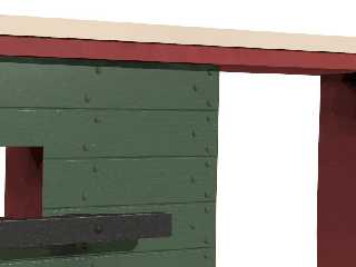

This post could be subtitled "Fun with trace"
The hull of the ship is made of bezier patches created in Hamapatch when I
first started to learn POV. I scaled two copies of the hull differently to
create the inner and outer surfaces of the hull. At the time I had no clue
how to fill the space between the two hull surfaces where the gun ports and
sweep ports were cut through the bezier patches, so I just scaled 10 more
copies of the hull and placed them between the outer and inner hulls. It
worked from a distance, but was not a good solution when viewed close up.
I recently noticed in my online research that ships of the period had bolts
or rivets holding the planks to the ships frame timbers on the interior of
theship. I decided to use the trace function to place them (scaled
spheres). Epiphany! I could use the same process to locate points on the
inner and outer hulls and use these points as vertexes for triangles. The
triangles could then be used to cover the gap between the inner and outer
hulls.
I think it works rather nicely! I used enough triangles to smoothely conform
to the curved hull.
The second proud moment of the day was creating a texture that would give
the smooth bezier patches the look and feel of 3 dimensional planks. Here
is that texture for anybody that is interested.

I think this has been a good day for me.
Tim

From: Chris
Subject: Re: Brig Niagara WIP (34k)
Date: 13 Oct 2005 21:25:00
Message: <web.434f07c755de2096705671040@news.povray.org>
Tim,
Great job. I like the wood texture too. According to a book I have at home
(Steele's Elements of Naval Architecture), most of the bolts holding the
planking to the frames would have been made of wood (oak was a favorite).
These "treenails" are typically 1.5" to 2" in diameter and may have been
rounded off where they poked through the interior of the hull. The reason
for the wood was that iron was expensive and it was also very dangerous
should a cannon ball knock the head off of the bolt and sent it flying into
the crew.
What a fantastic project. Keep up the good work.
Chris Holtorf

Clever solution to your problem, and those textures look fantastic.
Tim, the amount of work you are putting into this project is crazy, you
know that right?  Its going to be a stunning masterpiece when its done
though.  How are you planning on showing off the final result?
Skip

Message: <web.434f997b55de2096395d82550@news.povray.org>
"Chris" <lho### [at] nwlinkcom> wrote:
> Tim,
> the crew.
> Chris Holtorf
Good morning Chris and thank you for your comments. I am familiar with tree
nails and thought they were the rule. I based the iron rivets on this photo
of the USS Constitution whish is of the sme time period.
http://www.ussconstitution.navy.mil/Bowchasers.htm
I may have to do a little more investigation on this issue. So far I have
not been able to find clear images of the interior planking on the Niagara.
Tim
