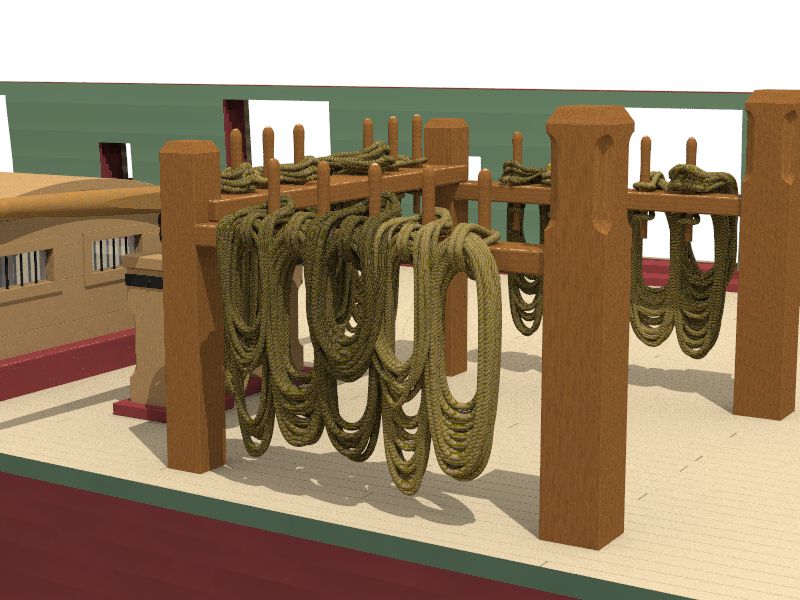

Here is my latest attempt at modeling coiled rope attached to a belaying
pin. I created a macro that allows me to control specific parameters such
as rope size, pigment darkness, number of turns, etc. The issue I had
before was that in photo's of real rigging, there are always big heaps of
messy coiled ropes & my previous attempts were just too clean. Combine the
desired messiness with the fact that not all ropes are the same size and
color & I just had to revisit this area of the model. I think this is much
better.
Tim
Download 'fife_rails_test_1.jpg' (78 KB)
Preview of image 'fife_rails_test_1.jpg'
From: David El Tom
Subject: Re: NIagara WIP Fife Rail (80k)
Date: 28 Sep 2005 15:12:06
Message: <433aeb06$1@news.povray.org>
> better.
> Tim
amazing work,...
even though on the second look the coils seems to penetrate each other
which would end up in an gordian knot :-)
I don't have a clue how to avoid this in a simple fashion.
Maybe you can get the extents of the allready existing coils and use
them as "forbidden volumes" while generating each coil after another.
... dave
From: Jim Charter
Date: 28 Sep 2005 15:48:30
Message: <433af38e@news.povray.org>
> better.
> Tim
Mind boggling. Fall of the coils looks very natural.  Texture needs
tweaking maybe.
From: Tim McMurdo
Date: 28 Sep 2005 19:50:01
Message: <web.433b2b96f20d7d63395d82550@news.povray.org>
> amazing work,...
> ... dave
Thank you very much. :) The overlapping coils have been an issue and I have
tried several solutions. So far everytime I clean up the overlap, the
effect becomes too clean. I have tried a slightly different version of the
forbidden volumes idea. I may give your version a try though.
Thanks,
Tim
From: Tim McMurdo
Message: <web.433b2c02f20d7d63395d82550@news.povray.org>
> tweaking maybe.
Thanks Jim,
THese are spere sweeps and unfortunately, I have not found a perfect
solution for applying a texture to the sweep. Still working on that part
though & thanks for your encouragement.
Tim
From: Skip Talbot
Date: 29 Sep 2005 00:41:21
Message: <433b7071$1@news.povray.org>
Actually I think your rope texture is fine.  It does appear to be
suffering from a moire pattern though.  Perhaps you could try rendering
without AA at a high resolution and then resizing down with Photoshop?
Extremely impressive work on this huge project, Tim.
Skip
Date: 29 Sep 2005 03:23:48
Message: <433b9684@news.povray.org>
"David El Tom" <dav### [at] t-onlinede> schreef in bericht
news:433aeb06$1@news.povray.org...
> amazing work,...
It is amazing work indeed!! Very well done! The ropes look very real.
The interpenetration is not so severe, I believe, and may only really show
up on close scrutiny. In most scenes that wouldn't be the case.
From: Paolo Gibellini
Date: 29 Sep 2005 10:04:53
Message: <433bf485@news.povray.org>
I'm astonished at the ropes!
Your Niagara is like a carthusian work!
Paolo

From: Marc Jacquier
Date: 29 Sep 2005 14:39:15
Message: <433c34d3$1@news.povray.org>
news:web.433adfae47694371acb32c570@news.povray.org...
Astounding, mind boggling, wait... it is McMurdoing!
Do you give yourself a deadline or anything like?
Marc
From: Rene Bui
Date: 29 Sep 2005 17:40:00
Message: <web.433c5ea0f20d7d63e72b3a00@news.povray.org>
> better.
> Tim
The ropes are very convincing, I can feel their weight.
