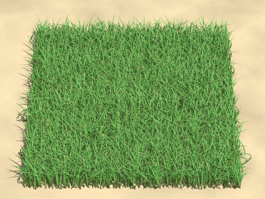

Here's a simple scene of grass, using the 'MultiMesh' technique I described
in the General message area.

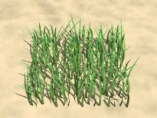

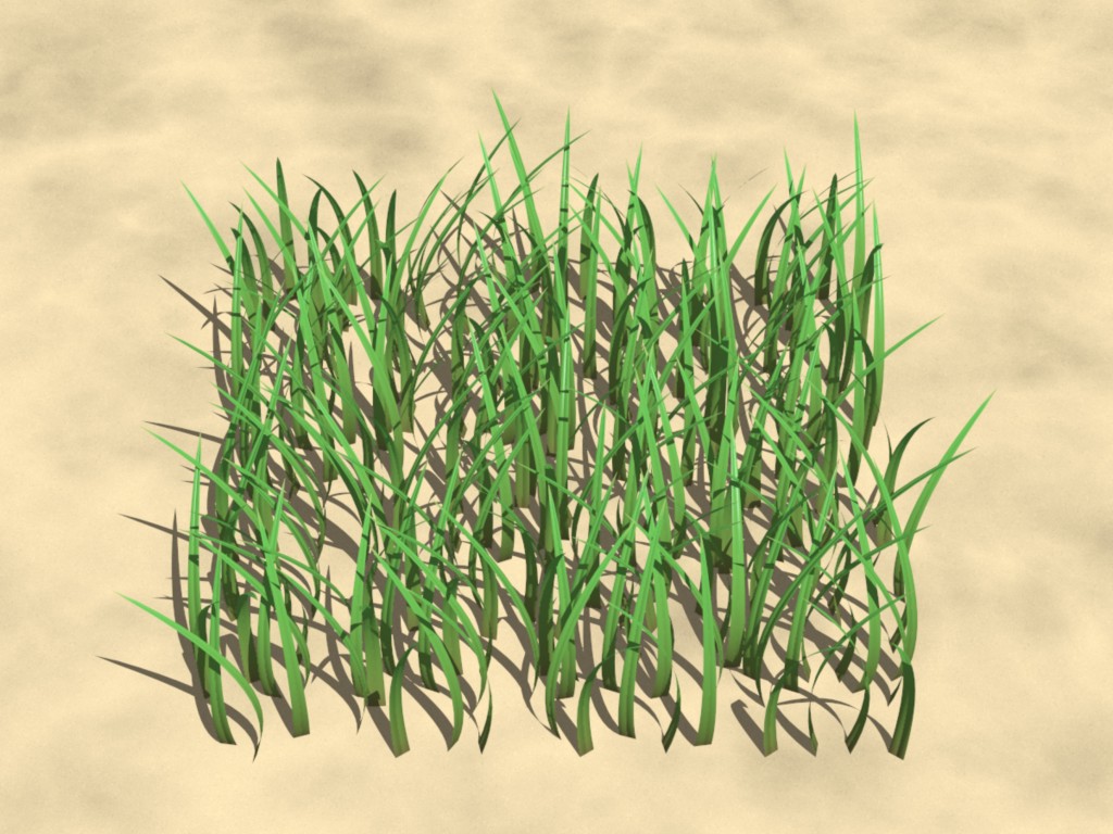

Download 'grassi3s.jpg' (283 KB)
Preview of image 'grassi3s.jpg'
From: PM 2Ring
Subject: Re: Grass using MultiMesh
Date: 5 Sep 2005 11:20:00
Message: <web.431c617ad597e82bd43d28a00@news.povray.org>
That message, BTW, was <web.431c5b735fa5904d43d28a00@news.povray.org>
Here's an image which uses a single mesh overlapped with itself. Even here,
its hard to notice the duplicate sub-meshes, unless you're looking for
them. :)
Download 'grassm0s.jpg' (187 KB)
Preview of image 'grassm0s.jpg'
