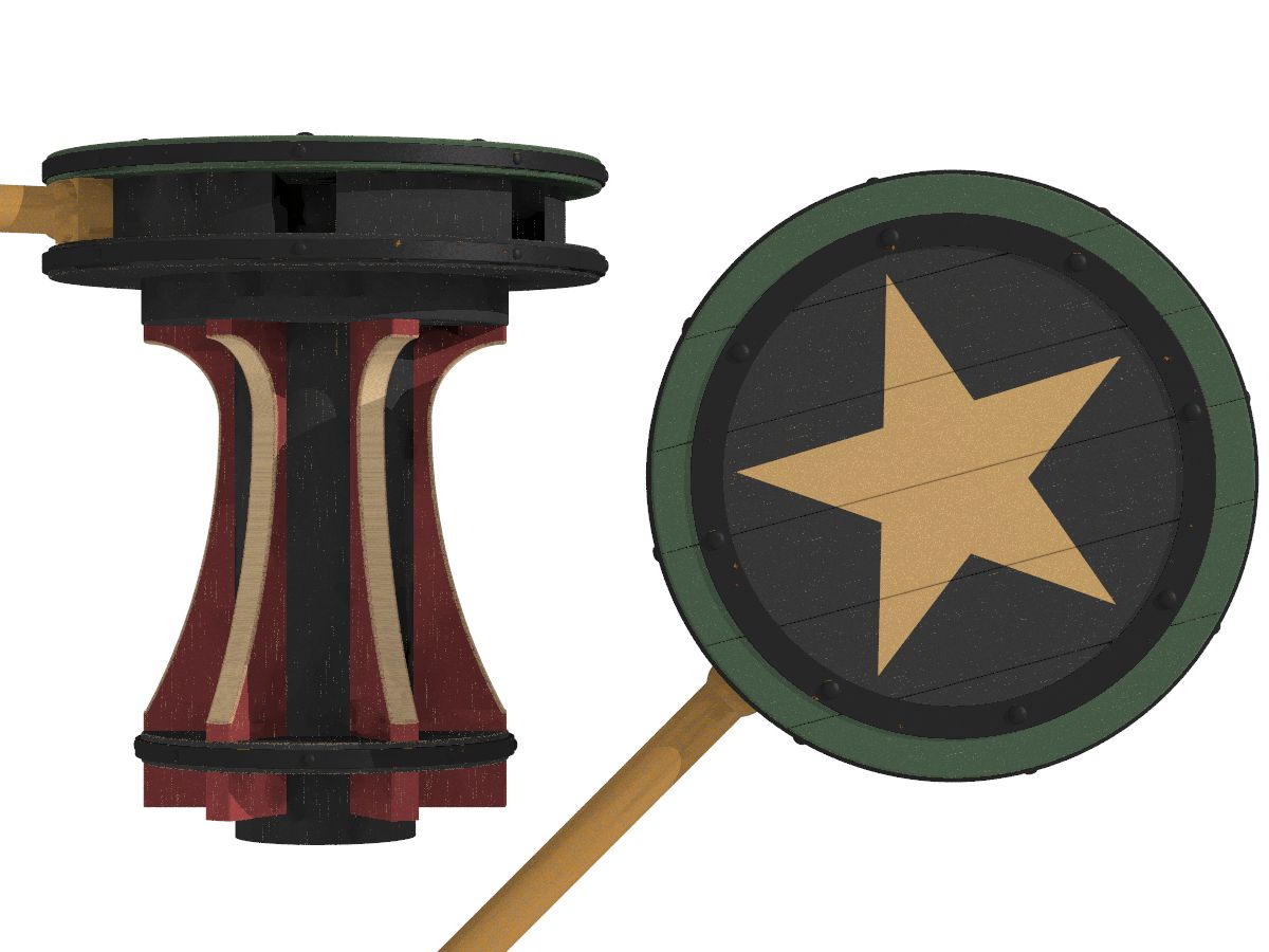

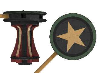

Ok..maybe I will change the varnised finish used on the capstan bars, but
the capstan is finished. I know the star is off center. When the star was
centered, it just didn't look right to me...too perfect. I set a flag that
determines when capstan bars are used. Normally they would be stowed away
unless the anchor was being raised.
I have to express my thanks to this community. It is the feed back and
encouragement that you have generously given to me that has brought my work
to this level. I hope that I can return something in kind to the community
in the future.
I used low radiosity settings, so please over look the poor quality of the
lighting.
Thanks,
Tim

An excellent painted+aged wood texture is a fine start :)

Very nice. How close to completion would you estimate this project to be?

Thanks Ross. I hadn't thought of it that way!

I expect that I have another solid year left to work on the ship itself.
Then comes the world that it will be placed in. I am planning a truly huge
variety of ports and other ships, boats, etc... I also plan a series of
stories to go along with then, representing a sort of journal for a member
of the ships crew.
I am experimenting with a LOD or Level Of Detail system for ships and other
large objects that eliminates detail as the object becomes more distant
from the camera.
Hope that helps,
Tim

Sounds like a life's work.
Great attention to detail though.

Excellent work Tim!! I am deeply impressed!

Oh hum.... <cough>
Well... you are doing a pretty good job, hum?
What I mean is that being a virtual ship builder myself (on and off) I know
perfectly well the amount of work that goes into it. I must admit that I am
far from the detailed work you are putting in. So, you are one of those
giants on which shoulders I would like to stand!  :-)
