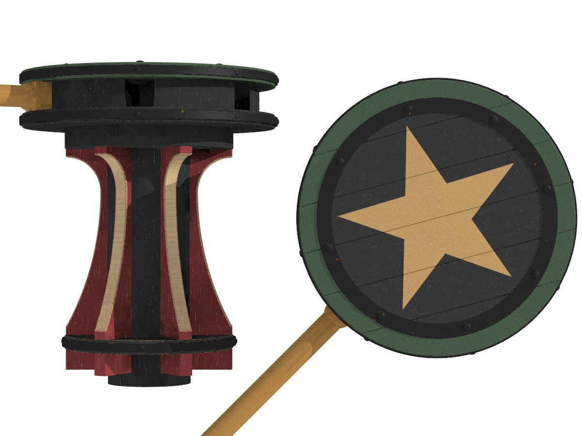

Ok..maybe I will change the varnised finish used on the capstan bars, but
the capstan is finished. I know the star is off center. When the star was
centered, it just didn't look right to me...too perfect. I set a flag that
determines when capstan bars are used. Normally they would be stowed away
unless the anchor was being raised.
I have to express my thanks to this community. It is the feed back and
encouragement that you have generously given to me that has brought my work
to this level. I hope that I can return something in kind to the community
in the future.
I used low radiosity settings, so please over look the poor quality of the
lighting.
Thanks,
Tim
All textures are proceedural. I modified and made corrections to the macro
used to generate the worn painted wood finish. Here is the new one:
RGB  is the RGB vector that describes the color being used.
WearFlatH and WearFlatV describe the amount of wear that is applied to the
horizontal and vertical surfaces.
WearEdge determines the wear applied to the rounded edges.
Norm is the normal used by the slope statement
Rot is the vector used to rotate the texture. The texture is rotated prior
to being translated.
Tran is the vector used to translate the texture
Scale is the vector used to scale the texture.

From: Ross
Subject: Re: Capstan fnished...I promise (92k)
Date: 2 Aug 2005 17:00:37
Message: <42efdef5$1@news.povray.org>
"Tim McMurdo" <jod### [at] wohrrcom> wrote in message
news:web.42efc7029ecf5192acb32c570@news.povray.org...
> in the future.
An excellent painted+aged wood texture is a fine start :)
From: Shay
Date: 2 Aug 2005 20:46:09
Message: <42f013d1$1@news.povray.org>
Tim McMurdo wrote:
Very nice. How close to completion would you estimate this project to be?
  -Shay
From: Tim McMurdo
Date: 2 Aug 2005 21:05:02
Message: <web.42f01773b911a84a6e93bf990@news.povray.org>
Thanks Ross. I hadn't thought of it that way!
From: Tim McMurdo
Date: 2 Aug 2005 21:10:00
Message: <web.42f01898b911a84a6e93bf990@news.povray.org>
I expect that I have another solid year left to work on the ship itself.
Then comes the world that it will be placed in. I am planning a truly huge
variety of ports and other ships, boats, etc... I also plan a series of
stories to go along with then, representing a sort of journal for a member
of the ships crew.
I am experimenting with a LOD or Level Of Detail system for ships and other
large objects that eliminates detail as the object becomes more distant
from the camera.
Hope that helps,
Tim
