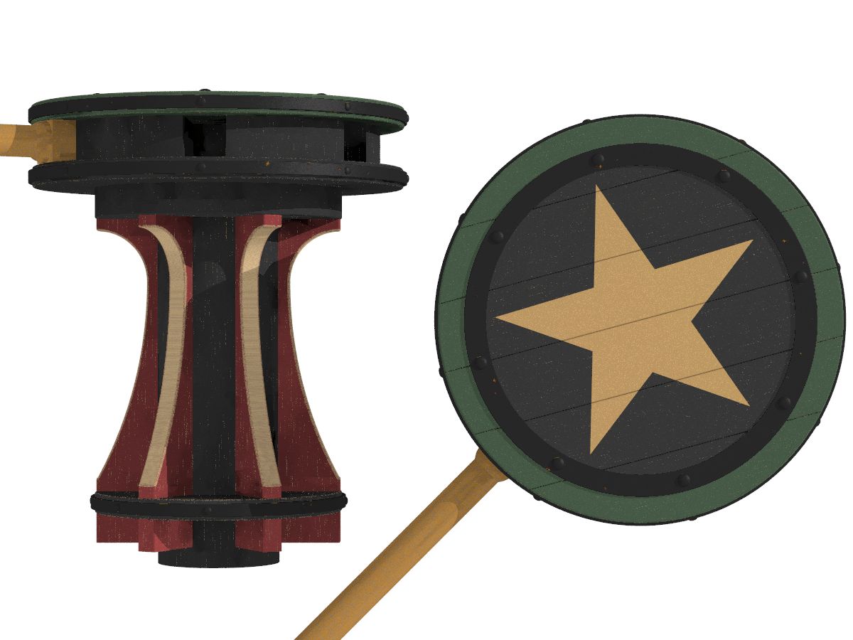

Ok..maybe I will change the varnised finish used on the capstan bars, but
the capstan is finished. I know the star is off center. When the star was
centered, it just didn't look right to me...too perfect. I set a flag that
determines when capstan bars are used. Normally they would be stowed away
unless the anchor was being raised.
I have to express my thanks to this community. It is the feed back and
encouragement that you have generously given to me that has brought my work
to this level. I hope that I can return something in kind to the community
in the future.
I used low radiosity settings, so please over look the poor quality of the
lighting.
Thanks,
Tim

From: Ross
Subject: Re: Capstan fnished...I promise (92k)
Date: 2 Aug 2005 17:00:37
Message: <42efdef5$1@news.povray.org>
"Tim McMurdo" <jod### [at] wohrrcom> wrote in message
news:web.42efc7029ecf5192acb32c570@news.povray.org...
> in the future.
An excellent painted+aged wood texture is a fine start :)
From: Shay
Date: 2 Aug 2005 20:46:09
Message: <42f013d1$1@news.povray.org>
Tim McMurdo wrote:
Very nice. How close to completion would you estimate this project to be?
  -Shay
From: Tim McMurdo
Date: 2 Aug 2005 21:05:02
Message: <web.42f01773b911a84a6e93bf990@news.povray.org>
Thanks Ross. I hadn't thought of it that way!
From: Tim McMurdo
Date: 2 Aug 2005 21:10:00
Message: <web.42f01898b911a84a6e93bf990@news.povray.org>
I expect that I have another solid year left to work on the ship itself.
Then comes the world that it will be placed in. I am planning a truly huge
variety of ports and other ships, boats, etc... I also plan a series of
stories to go along with then, representing a sort of journal for a member
of the ships crew.
I am experimenting with a LOD or Level Of Detail system for ships and other
large objects that eliminates detail as the object becomes more distant
from the camera.
Hope that helps,
Tim
From: Anthony D  Baye
Date: 2 Aug 2005 23:13:53
Message: <42f03671@news.povray.org>
> of the ships crew.
> from the camera.
> Hope that helps,
> Tim
Sounds like a life's work.
Great attention to detail though.
A.D.B.
Date: 3 Aug 2005 03:56:32
Message: <42f078b0@news.povray.org>
"Tim McMurdo" <jod### [at] wohrrcom> schreef in bericht
news:web.42f01898b911a84a6e93bf990@news.povray.org...
be?
> of the ships crew.
other
> from the camera.
> Hope that helps,
Excellent work Tim!! I am deeply impressed!
From: Tim McMurdo
Date: 3 Aug 2005 07:40:00
Message: <web.42f0ace0b911a84a6e93bf990@news.povray.org>
> Regards,
> A.D.B.
Yes, it seems that way. I am very much enjoying it. Thank you for your
comments!
Tim
