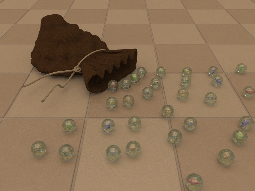

Actually it's my second post but thought I should do a proper first post.
This is my first megapov image so I thought I would jump straight in and
create my first HDRI image as well. I created my own probe using my povcomp
entry (Natural History Museum).
I know the tiles could do with a bit more work on the textures and even the
modelling but this was more about testing how HDR actually works.
The scene is one I created a while ago with a wooden floor, I just changed
the floor to be tiled so it would fit the 'first post' rule..
Any hints and tips on using HDRI would be very appreciated as I am not too
sure what I am doing. (e.g. do photons work properly with HDR? do I need to
specify anything extra you would normally add them to the light source but
I do not know if you can add them to the HDRI light source?)
I may have to do a really shiny chrome ball image as well because I think
they just look sooo good with HDRI.
Thanks,
Sean
Your HDRI image needs to include an extremely bright spot. Then soft
caustics will happen automagically. If you want sharp, bright caustics,
you'll need to have a separate photons scene, map the photons, and use the
map in the final image. Remember, HDRI's are NOT light sources- they are
just images. As such, POV would have no way of knowing where to direct
photons from. Radiosity does, however, do soft caustics all by itself. if
you put a nice big glass sphere in a scene with a bright HDR image (try on
of the outdoor scenes Paul Debevec has up for examination), and set your
count extremely high, you'll see it.
-s

Thanks for the advice, I will try these two techniques. I couln't work out
where the photons were comming from in the image, I had photons turned on
but wasn't really sure if I would see any due to the lack of a light
source. The photons were not very visible but I now see they must be from
the radiosity settings. Lots more experimenting to do...
Sean
