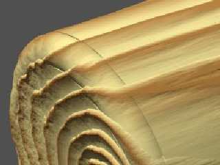

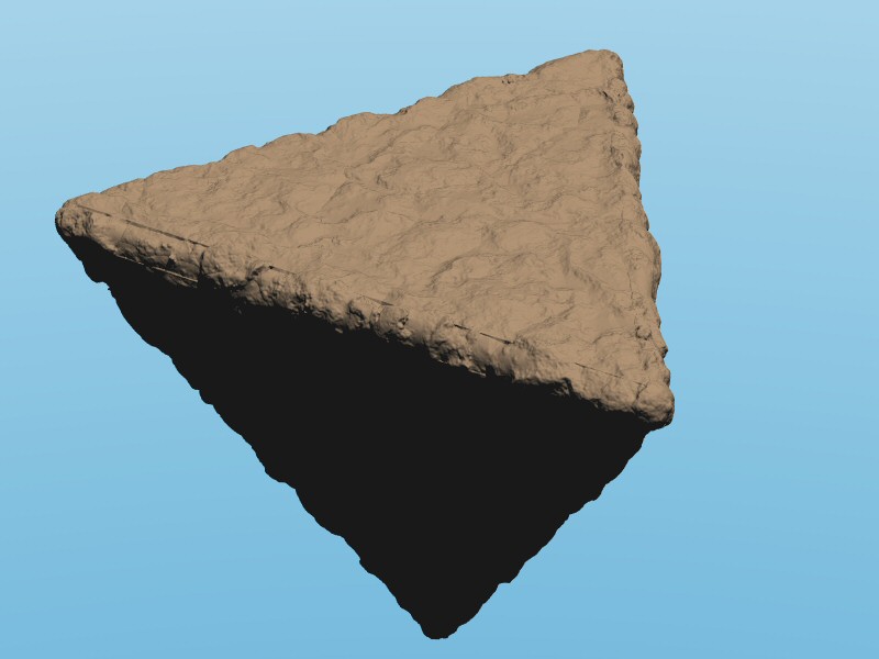

Right then, all you isosurface gurus out there: perhaps you can help me with
this.
Here's the problem. I'm trying to create a tetrahedral asteroid using an
isosurface. I've written a function which comprises four spheres, six
cylinders and a tetrahedron with its vertices and edges trimmed using a
functional intersection, merged to produce a perfect rounded tetrahedron
(first picture). I'm then boulderifying this base shape by adding crackle
and agate pigment functions.
No problem so far, I hear you say.
However, there appears to be a mismatch between the planar faces and the
curved edges which produces "fault lines" (second picture). I've tried
upping accuracy and max_gradient to no avail, and I've tried adding /
subtracting the pigment functions in various combinations - no good. Can
anyone shed any light on this bizarre artefact?
Source code, in case I'm being stupid:

#declare Boulder = isosurface {
                        function { fn_rounded_tetra(x,y,z,10,1)
                                   + fn_agate(x/4,y/4,z/4).gray*0.3
                                   - fn_crack(x/4,y/4,z/4).gray*0.75 }
                        max_gradient 4
                        contained_by { box {-15, 15 } }
                        pigment { color White } }
Download 'tetra2.jpg' (25 KB)
Preview of image 'tetra2.jpg'
From: Bill Pragnell
Subject: Re: isosurface problem
Date: 11 May 2005 11:55:01
Message: <web.42822a3875855243731f01d10@news.povray.org>
Couldn't post two pics. Heres the secon pic with the offending glitch.
Bill
Download 'tetra1.jpg' (46 KB)
Preview of image 'tetra1.jpg'
For a well working displacement you need your base function to be a
correct distance function of the shape you want to displace - as Mike
pointed out your function isn't.
You could for example use the IsoCSG library:
http://www.tu-bs.de/~y0013390/pov/ic/index.html
and create a merge of three triangles which would meet this condition (i
think so - have not tested actually). Note using the builtin triangle
function in MegaPOV would make this faster.

I don't think that approach is ever going to work. [See my previous reply
for my reasoning]
What you can do however is take the four faces of a simple tetrahedron
and 'blob' them together to get a rounded effect.
[see <http://www.econym.demon.co.uk/isotut/combine.htm#blob> for function
'blobbing']
The rounded effect isn't the same as what you get with planes, cylinders
and spheres. The radius of curvature changes gradually rather than
suddenly changing from zero to b at a point near the edge. The faces are
not completely flat.
In order to get this to work, the size of "contained_by" box must be the
same as the 'radius' of the tetrahedron, otherwise you get "inside out
bits" from all the places that are "inside" an even number of planes.
Because the multiplied gradients are higher, the max_gradient becomes
unfortunately very large, and the pigment functions need to be made much
stronger.
Since there's now no "b", the bits that look like
 "sin(radians(f_f)/2)+b) / sin(radians(f_f)/2)"
evaluate to 1, which simplifies things a bit. Giving a complete scene
file that looks something like this:

> 'blobbing']
That's brilliant! It would never have occurred to me to blob planes together
like that. Really elegant. The difference in rounding effect is not a
problem - the result of your code is actually better (i.e. more realistic)
than what I would have ended up with. Yours renders faster than mine, too!
I need it a little craggier than your demo but I can play with that myself.
Just goes to show - if it's complicated and doesn't work, you're probably
pushing a boulder up the wrong mountain.
And you feel extra stupid if the boulder turns out to be tetrahedral.
Much thanks, and others' suggestions too.
Bill

Hi
That looks like a problem I had with an isosurface rounded cylinder
macro. No problem until I added a random wood pigment function and
tried to auto-scale it to add to the isosurface.
I linked to this image, which is dated 8 Jan 2003, when I yelled for
help on p.g or p.a-u but can't find the thread now. The answer is on
this server somewhere ;)
Alf
