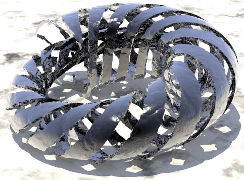

From: Mienai
Subject: Re: Isosurface self shadow?
Date: 10 Mar 2005 17:05:02
Message: <web.4230c3f6e6da3c07ab83a5640@news.povray.org>
k, so here's the code to my first object right now, sorry about the mess :).
#local trn=3;
#local r=.25;
union{
 #while (trn>0)
  intersection{
   isosurface{
    function{
     f_helix1 (f_r(x,y,z)-3, f_th(x,y,z), y, 4, 4, .05,
      #if (trn=2)
       -atan(x/(abs(z)+.0000001))/(2*pi)+(.5*trn-r)
      #else
      #end
      , 2, 0, 0)
     - f_agate(x/2,y/2,z/2)*.01
    contained_by{sphere{<0,0,0>,8}}
    #if(trn=1)
     max_gradient 15.0
    #end
    #if (trn=2)
     max_gradient 1.4
    #end
    #if(trn=3)
     max_gradient 3.4
    #end
    max_trace .01 all_intersections
    accuracy .00001
   #if (trn=2)
    plane{-z,0}
   #else
    plane{z,0}
   #end
  #local trn=trn-1;
 #end
 hollow
 pigment {Black}
 finish{
  Phong_Shiny
  reflection{,1}
So if you're wondering what I'm trying to do, I've taken the spiral function
and changed it so it's a spiraled torus, but then I modded it again so that
as it wraps around the y-axis, it's minor radius decreases.  The result
looks similar to the MC Escher picture 'Spirals.'  I had to do it in 3
sections because of the nature of the function, so that's why theirs a
loop.  I thought that looked too flat so I subtracted some f_agate() from
it to give it some texture.  All the max_gradients are optimised for the
individual parts, and I added in the max_trace becase I was loosing the
visibility of some portions looking through it.  This is my first run with
the accuracy altered from default but that shadowing problem was evident in
the previous run (which took ~12hrs, picture below) despite being under a
reflective finish, I could still see the shadowing pixelation.
The end result is something that took several hours to render without the
finish on, I don't remember how many.  Right now I'm running it at high
radiosity settings on my dual P3 866MHz machine (2 threads, the image is
split into 2) and is just about pre-rendering @~12hrs.  And I'm sure it may
come up so here's my radiosity settings:
radiosity {
 pretrace_start 0.08
 pretrace_end   0.005
 count 400
 error_bound 0.1
 recursion_limit 1
Any thoughts?  I'll post an image when it finishes.
Download 'spirals5.jpg' (78 KB)
Preview of image 'spirals5.jpg'

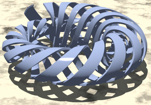

From: Mienai
Date: 10 Mar 2005 17:10:00
Message: <web.4230c4a1e6da3c07ab83a5640@news.povray.org>
Here's an earlier run with out the reflextion and accuracy adjustment, you
can see the shadow better.
Download 'spirals4.jpg' (68 KB)
Preview of image 'spirals4.jpg'
From: Slime
Date: 10 Mar 2005 18:20:38
Message: <4230d646$1@news.povray.org>
OK. Here are some tips:
all_intersections (and you can remove max_trace since all_intersections
overrides it) slows things down significantly. I recognize that it can be
necessary when used in an intersection, but your intersections are simple
and they can be eliminated by either changing the isosurface functions (with
max(z, ...) and max(-z, ...)) or by using a box for contained_by which cuts
the isosurface off at the appropriate place. Then only the first
intersection of the isosurface needs to be found which speeds up the render.
I've used the former choice.
The agate function is being evaluated many times and is considerably slowing
things down, yet it only has a very slight effect on the surface. You can
remove it from the function and put it into a normal{} block instead, and
that will probably create almost exactly the same effect while making things
a lot faster. This also may let you decrease the max_gradients (I haven't
bothered to try).
Your contained_by object is a sphere which is much bigger than the object
itself (mostly in the vertical direction). You would probably benefit from
using boxes instead, using a separate, tighter one for each of your three
isosurfaces. (This also lets you remove the max() calls from the function
that I mentioned earlier.)
You can simplify your atan calls to atan2(x,abs(z))
After my changes - I'm not sure if they're what helped or not - I didn't
have any shadow problems with an accuracy of .0001.
