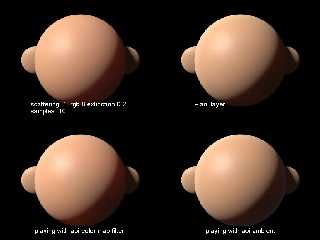

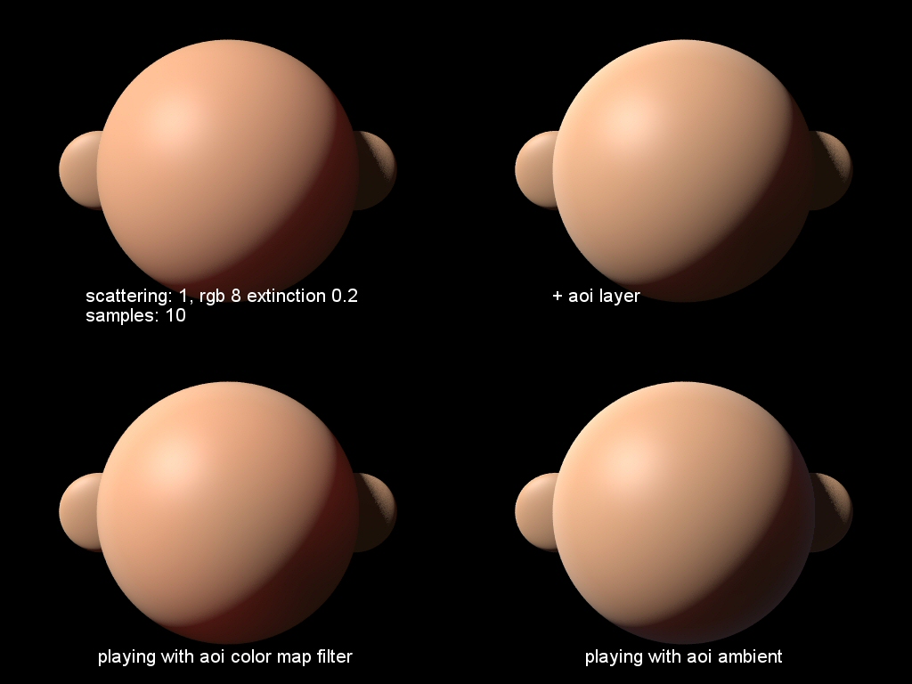

1 - Mixed sss and aoi (mlpov0.83/megapov1.1) : not too bad, I think it's ok.
Aoi is quite helpful, especially when an image map is used as last layer
(the white edge is usually lost).
Script posted in p.b.s-f.

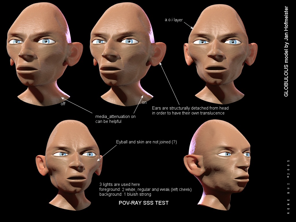

Toying with Globulous (a model by Jan Hofmeister)
Rene

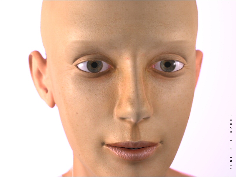

an early Chuck Close-like portrait (sss+aoi)
Rene

Wow, looking very good.
I think the eyes should be a little more shiny, they look a little 'dry' at
first glance.
The lips look pretty good.
There seems to be a line over the cheekbone - was that intentional?
I love the wrinkles around the eye, I assume that's modelled or did you use
a bump map here?
I didn't use your technique in my latest image, but I will soon
        == John ==
Thanks
>first glance.
You're right, but I was so concentrated on skin problem that I forgot to
work on eyes texture.
Thanks again
hmm.. not really, there is something wrong here with the model (a too flat
area) and unfortunately the light... :(
>a bump map here?
it's a hand-made bump map.
Rene
