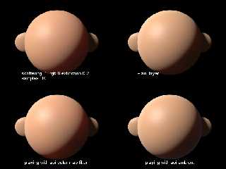

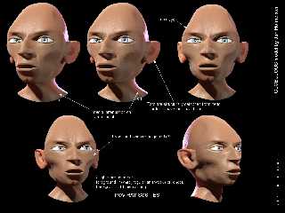

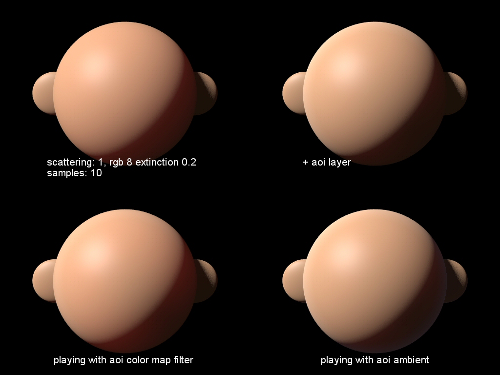

Hi folks,
I'm back with some new things to share.
1 - Mixed sss and aoi (mlpov0.83/megapov1.1) : not too bad, I think it's ok.
Aoi is quite helpful, especially when an image map is used as last layer
(the white edge is usually lost).
Script posted in p.b.s-f.
2 - As anyone knows, a serious problem with making sss human skin in pov is
transparency tuning, particularly with head due to its structure (inner
parts).
- I always read here (in the newsgroup) that we just have to increase media
density to turn it more opaque. Well, I noticed it's true only when main
light is from behind. But when main light is in front, I discovered that it
is absolutely the opposite, we have to *decrease* this value (?!)...
- extinction is useful when tweaking
- big time-consumer, high value sampling is used as last resort if density
and extinction are not sufficient.
Some examples here using scattering type 1 in different lighting situations:
Because human skin is one of the most subtle and inconstant material, it is
not a straight method (I'm not capable to do one !), just to refer as memo.
http://bambousette.free.fr/head_experiment/povsss+lightBackgrd.jpg
http://bambousette.free.fr/head_experiment/povsss+lightFB.jpg
http://bambousette.free.fr/head_experiment/povsss+lightForegrd.jpg
http://bambousette.free.fr/head_experiment/povsss+lightSide.jpg
3 - I've also tried with non-sss technics, not convincing at all (except
aoi).
http://bambousette.free.fr/head_experiment/non-sss_skintest.jpg
4 - I've tried with other 'things', but unsuccessfully.
[ Jaime : I've tested your 3d cafe skull idea, but unfortunately does'nt
work here. I don't know how you really did it. Probably you are very
inspired. Jaime, ...are you a sort of wizard ? lol ]
http://bambousette.free.fr/head_experiment/other_sssexperiment.jpg
Rene

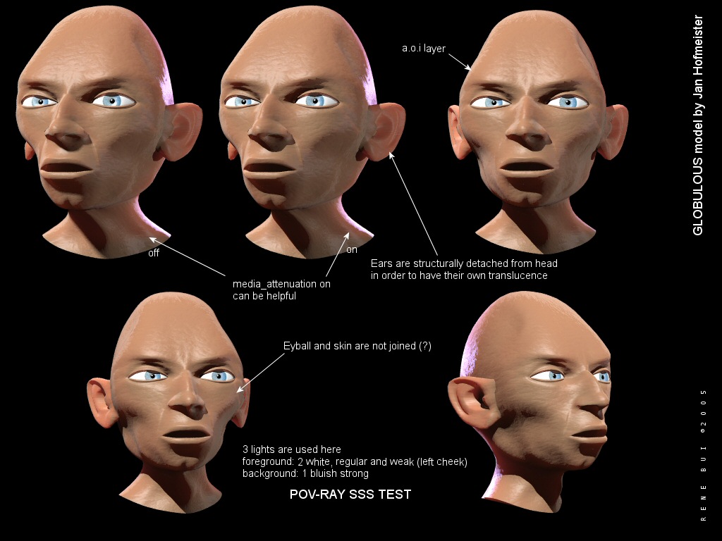

Toying with Globulous (a model by Jan Hofmeister)
Rene

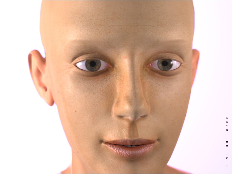

an early Chuck Close-like portrait (sss+aoi)
Rene

Wow, looking very good.
I think the eyes should be a little more shiny, they look a little 'dry' at
first glance.
The lips look pretty good.
There seems to be a line over the cheekbone - was that intentional?
I love the wrinkles around the eye, I assume that's modelled or did you use
a bump map here?
Thanks
>first glance.
You're right, but I was so concentrated on skin problem that I forgot to
work on eyes texture.
Thanks again
hmm.. not really, there is something wrong here with the model (a too flat
area) and unfortunately the light... :(
>a bump map here?
it's a hand-made bump map.
Rene

Very impressive, although some of them look a little 'waxy'.
>   Looks like it's not a bad idea, but I fear the work required to create
> my own skull, and then remodeling the head to fit the same shape...
What about using an image map to do it?
A map would have the advantage of being able to control the effect near
elbows and knees, which would be a little 'thicker'.
Look at the following product:
http://market.renderosity.com/softgood.ez?ViewSoftgood=34302
This is using Poser's renderer, but the same Aoi trick can be (better) used
with POVRay.  I have to admit it's tempting to get the product and see what
the maps he uses look like.
        == John ==
