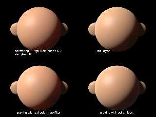

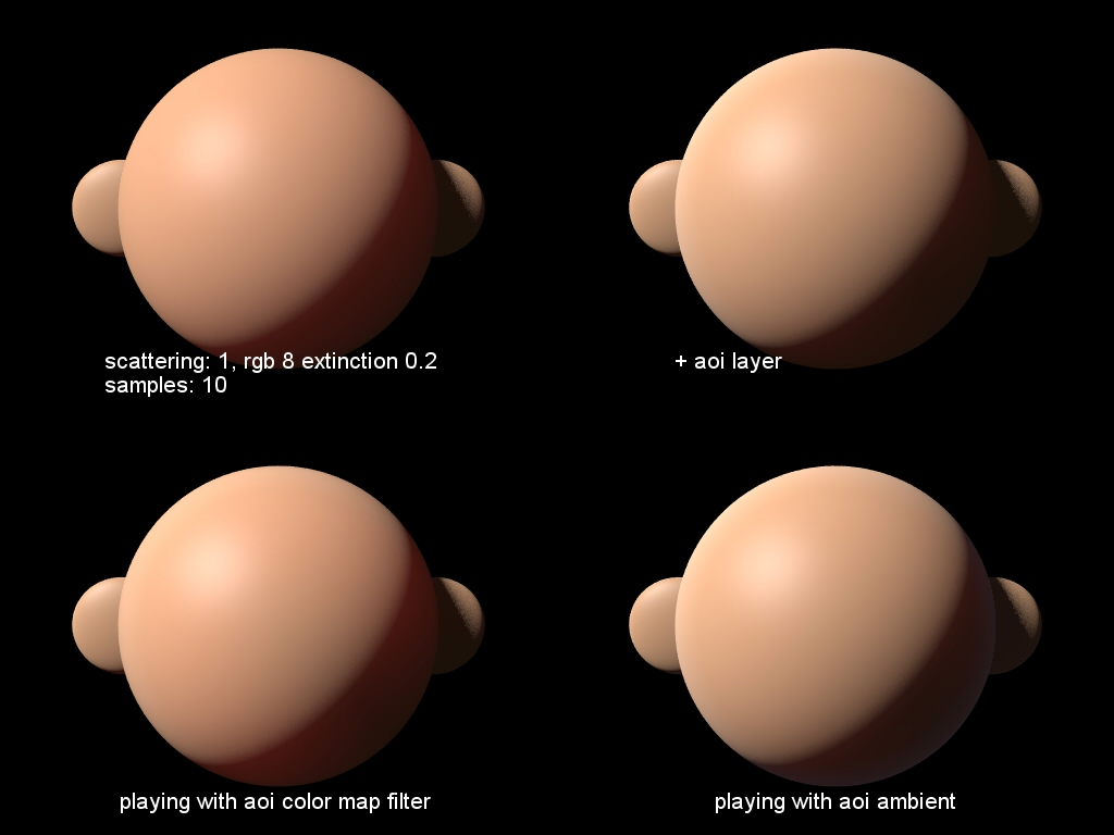

I'm back with some new things to share.
1 - Mixed sss and aoi (mlpov0.83/megapov1.1) : not too bad, I think it's ok.
Aoi is quite helpful, especially when an image map is used as last layer
(the white edge is usually lost).
Script posted in p.b.s-f.
2 - As anyone knows, a serious problem with making sss human skin in pov is
transparency tuning, particularly with head due to its structure (inner
parts).
- I always read here (in the newsgroup) that we just have to increase media
density to turn it more opaque. Well, I noticed it's true only when main
light is from behind. But when main light is in front, I discovered that it
is absolutely the opposite, we have to *decrease* this value (?!)...
- extinction is useful when tweaking
- big time-consumer, high value sampling is used as last resort if density
and extinction are not sufficient.
Some examples here using scattering type 1 in different lighting situations:
Because human skin is one of the most subtle and inconstant material, it is
not a straight method (I'm not capable to do one !), just to refer as memo.
http://bambousette.free.fr/head_experiment/povsss+lightBackgrd.jpg
http://bambousette.free.fr/head_experiment/povsss+lightFB.jpg
http://bambousette.free.fr/head_experiment/povsss+lightForegrd.jpg
http://bambousette.free.fr/head_experiment/povsss+lightSide.jpg
3 - I've also tried with non-sss technics, not convincing at all (except
aoi).
http://bambousette.free.fr/head_experiment/non-sss_skintest.jpg
4 - I've tried with other 'things', but unsuccessfully.
[ Jaime : I've tested your 3d cafe skull idea, but unfortunately does'nt
work here. I don't know how you really did it. Probably you are very
inspired. Jaime, ...are you a sort of wizard ? lol ]
http://bambousette.free.fr/head_experiment/other_sssexperiment.jpg

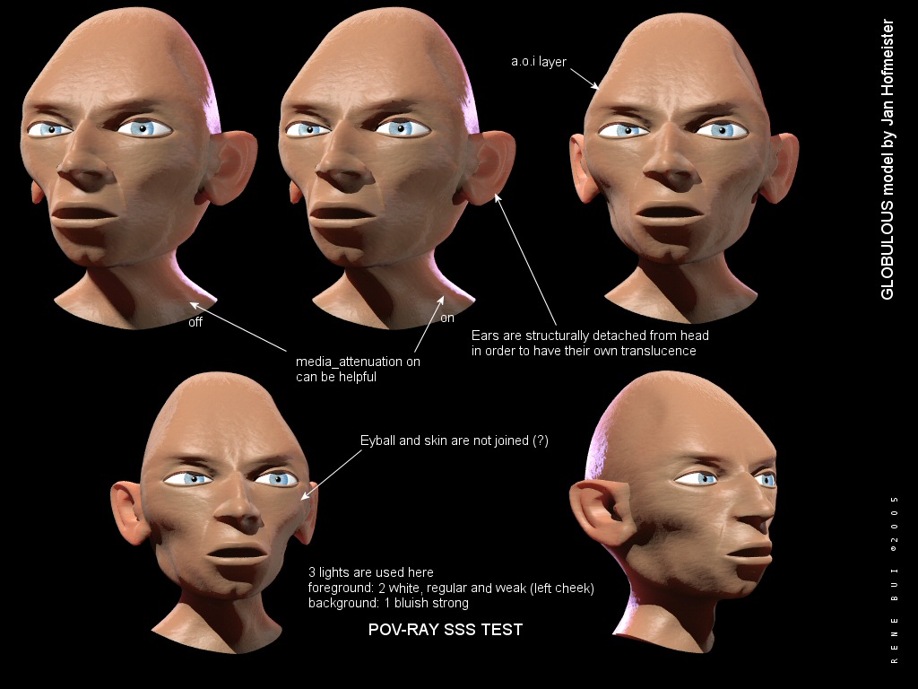

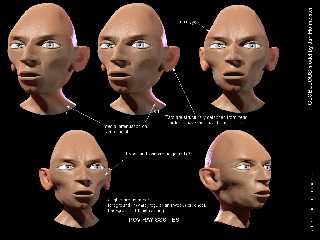

Toying with Globulous (a model by Jan Hofmeister)
Rene

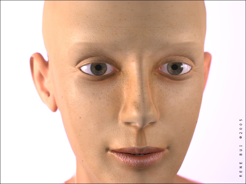

an early Chuck Close-like portrait (sss+aoi)
Rene

Wow, looking very good.
I think the eyes should be a little more shiny, they look a little 'dry' at
first glance.
The lips look pretty good.
There seems to be a line over the cheekbone - was that intentional?
I love the wrinkles around the eye, I assume that's modelled or did you use
a bump map here?
I didn't use your technique in my latest image, but I will soon
        == John ==
Thanks
>first glance.
You're right, but I was so concentrated on skin problem that I forgot to
work on eyes texture.
Thanks again
hmm.. not really, there is something wrong here with the model (a too flat
area) and unfortunately the light... :(
>a bump map here?
it's a hand-made bump map.
Rene
