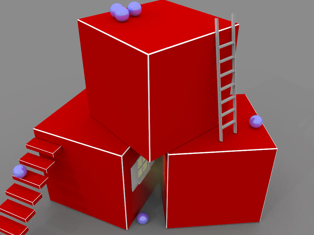

I'm not sure if I'm going to  take this anywhere, but I was inspired by Shay
to try hand coding some meshes. While it was about three hundred billion
times harder, it actually gives a sense of realism, to have the edges
beveled like that. Interesting texture options, too. Also, this is the
first image where I felt my lighting was technically competent. Anyway,
tell me what you think.

stm31415 wrote:
Looks like you're going all out. Hollow boxes and I can see the bevels
on the ladder.
  -Shay
> Shay to try hand coding some meshes. While it was about three hundred
> billion times harder, it actually gives a sense of realism, to have the
> edges beveled like that. Interesting texture options, too. Also, this is
> the first image where I felt my lighting was technically competent.
> Anyway, tell me what you think.
I like it - especially the detail on the ladder (which I only saw 'cause
Shay mentioned it). I especially like the red/white box edges. How did you
do those?

I wrote a macro that makes a beveled box of any size (and bevel) with a
different specified texture for the faces and the bevels. If you use two
different colors, it gives a funky, folded-paper sort of look. I'm not
positive the colors will stay this way, I just like the look.
I had been using file IO to do this, but now I see that Tim Nikias uses
arrays, which might be an interesting thing to try. At the moment, though,
I really have to get to school ;)
-S
