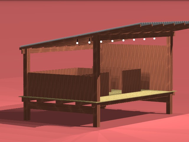

How do I get corrugated roofing to work in this image? I can get the texture
effect to work using normals but the roof does not corrugate
Download 'platform.jpg' (24 KB)
Preview of image 'platform.jpg'

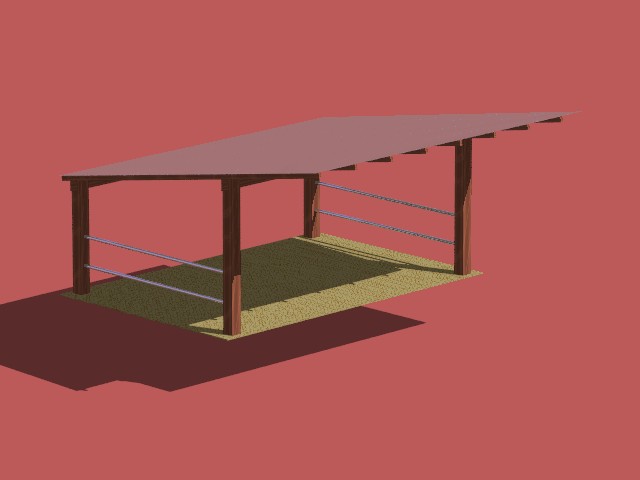

Subject: Re: Corrugated Roofing
Date: 28 Dec 2004 21:12:22
Message: <41d21286$1@news.povray.org>
If only a normal is used you can only see it as light/shadow changes on an
otherwise flat surface. Faster to render. Example:
normal {function {abs(x)} sine_wave scale 0.1}
Best way would be to use a sine wave function in an isosurface to get the
actual shape. Here is a 3' by 16' panel.
#declare Freq=20;
isosurface {
    function {
         y-sin(x*Freq)/25
    contained_by {
     box {<-1.5,-1,-8>,<1.5,1,8>} // could change x and z (W and L)
    max_gradient 2 // adjust
    open // make surface only
    pigment {rgb 1}
    scale 1
I see Aaron Gillies has replied, too, about using HF. Which is certainly
another possibilty, although not as easy and convenient.
Mike Williams has a isosurface tutorial (much suggested reading) showing a
way to create a thickness, too, if that might matter. See last example at:
http://www.econym.demon.co.uk/isotut/substitute.htm
Bob H.
From: Bathurstfreak
Date: 29 Dec 2004 07:45:01
Message: <web.41d2a62a9b0fd5ad127a3fdf0@news.povray.org>
> #declare Freq=20;
> isosurface {
>     function {
>          y-sin(x*Freq)/25
>     contained_by {
>     pigment {rgb 1}
>     scale 1
Cheers, I'll be sure to give you cred in my IRTC entry, but if I forget,
here it is.
Download 'platform.jpg' (44 KB)
Date: 30 Dec 2004 05:12:19
Message: <41d3d483@news.povray.org>
"Bathurstfreak" <bat### [at] hotmailcom> wrote in message
news:web.41d2a62a9b0fd5ad127a3fdf0@news.povray.org...
No need to do that. Was just a simple bit of help.
Your roof here looks much like the carport roof I built with the same kind
of corrugated metal that I included in a model of my home made in POV-Ray,
which is how I knew about the way to make it. Is 20' L by 16' W with five 4"
X 4" posts on one side and other, higher side, attached to the home.
About your rendered image... Will you be using light source fading? Right
now I can't tell much about the lighting, it has a high ambient appearance,
or perhaps a shadowless light source.
