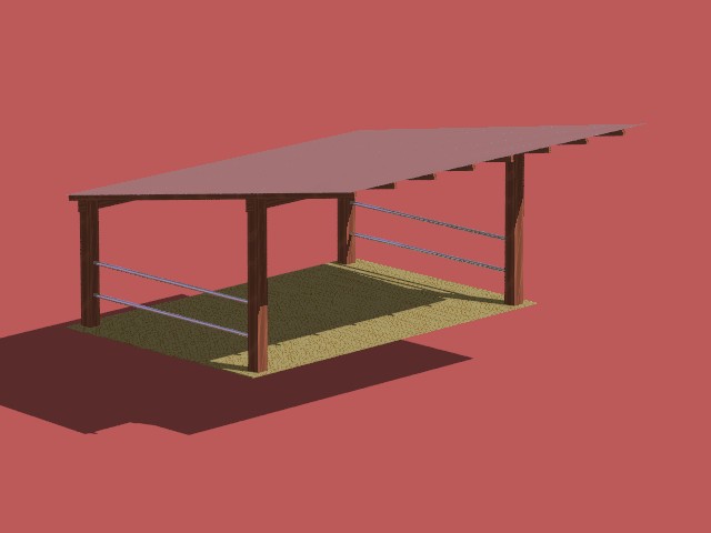

How do I get corrugated roofing to work in this image? I can get the texture
effect to work using normals but the roof does not corrugate
Download 'platform.jpg' (24 KB)
Preview of image 'platform.jpg'

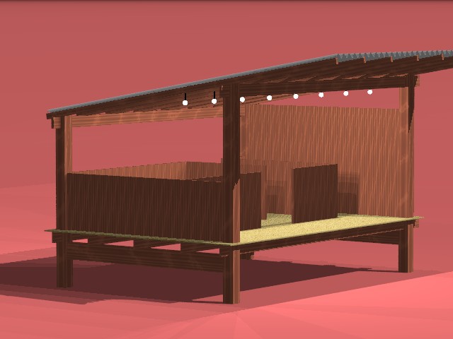

Cheers, I'll be sure to give you cred in my IRTC entry, but if I forget,
here it is.
Download 'platform.jpg' (44 KB)

About your rendered image... Will you be using light source fading? Right
now I can't tell much about the lighting, it has a high ambient appearance,
or perhaps a shadowless light source.
