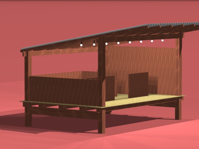

How do I get corrugated roofing to work in this image? I can get the texture
effect to work using normals but the roof does not corrugate
Download 'platform.jpg' (24 KB)
Preview of image 'platform.jpg'

From: Bathurstfreak
Subject: Re: Corrugated Roofing
Date: 29 Dec 2004 07:45:01
Message: <web.41d2a62a9b0fd5ad127a3fdf0@news.povray.org>
> #declare Freq=20;
> isosurface {
>     function {
>          y-sin(x*Freq)/25
>     contained_by {
>      box {<-1.5,-1,-8>,<1.5,1,8>} // could change x and z (W and L)
>     max_gradient 2 // adjust
>     open // make surface only
>     pigment {rgb 1}
>     scale 1
Cheers, I'll be sure to give you cred in my IRTC entry, but if I forget,
here it is.
Download 'platform.jpg' (44 KB)

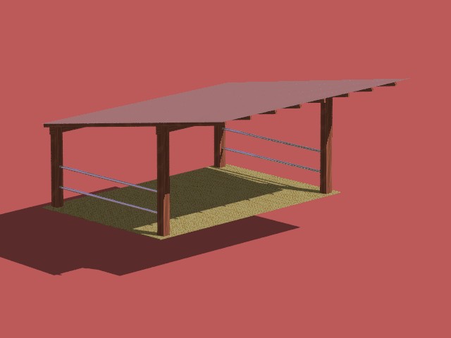

Date: 30 Dec 2004 05:12:19
Message: <41d3d483@news.povray.org>
"Bathurstfreak" <bat### [at] hotmailcom> wrote in message
news:web.41d2a62a9b0fd5ad127a3fdf0@news.povray.org...
No need to do that. Was just a simple bit of help.
Your roof here looks much like the carport roof I built with the same kind
of corrugated metal that I included in a model of my home made in POV-Ray,
which is how I knew about the way to make it. Is 20' L by 16' W with five 4"
X 4" posts on one side and other, higher side, attached to the home.
About your rendered image... Will you be using light source fading? Right
now I can't tell much about the lighting, it has a high ambient appearance,
or perhaps a shadowless light source.
