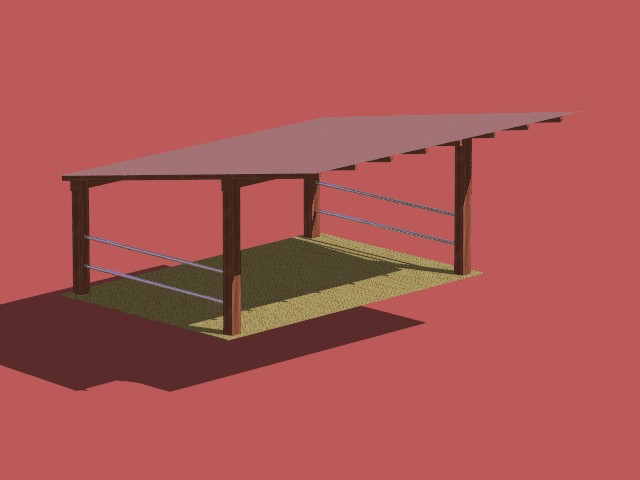

How do I get corrugated roofing to work in this image? I can get the texture
effect to work using normals but the roof does not corrugate

I'm not sure that this is exactly what you are after, but can you use a
height field and an internal bitmap?

If only a normal is used you can only see it as light/shadow changes on an
otherwise flat surface. Faster to render. Example:
normal {function {abs(x)} sine_wave scale 0.1}
Best way would be to use a sine wave function in an isosurface to get the
actual shape. Here is a 3' by 16' panel.

I see Aaron Gillies has replied, too, about using HF. Which is certainly
another possibilty, although not as easy and convenient.
Mike Williams has a isosurface tutorial (much suggested reading) showing a
way to create a thickness, too, if that might matter. See last example at:
http://www.econym.demon.co.uk/isotut/substitute.htm
Bob H.

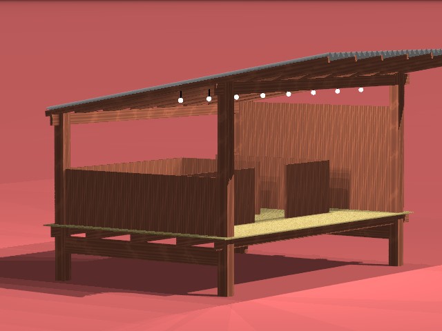

Cheers, I'll be sure to give you cred in my IRTC entry, but if I forget,
here it is.

No need to do that. Was just a simple bit of help.
Your roof here looks much like the carport roof I built with the same kind
of corrugated metal that I included in a model of my home made in POV-Ray,
which is how I knew about the way to make it. Is 20' L by 16' W with five 4"
X 4" posts on one side and other, higher side, attached to the home.
About your rendered image... Will you be using light source fading? Right
now I can't tell much about the lighting, it has a high ambient appearance,
or perhaps a shadowless light source.
