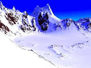

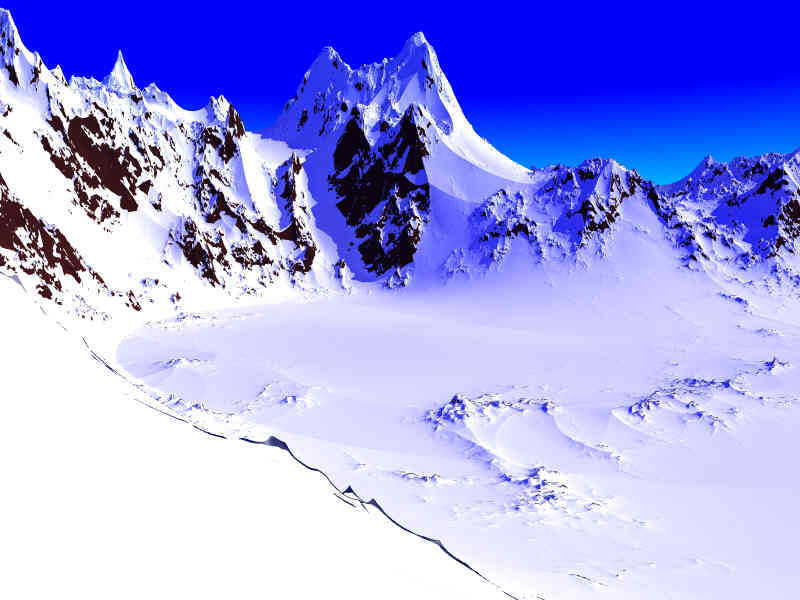

Whilst the weather over here has been swinging wildly between Winter
and Summer (it's yet to try Spring :-) I've tried my hand at Ridged
Multi-fractals.
It's a work in progress, comments are welcome.
Justin Whitton
_/\__/ mail: jus### [at] rayjayclaracouk \__/\_
 \/  \ web: www.rayjay.clara.co.uk             /  \/
Download 'lstest.jpg' (48 KB)
Preview of image 'lstest.jpg'

Great thing for some Antarctica scene.  The ridges make for good snow drifts.
> Multi-fractals.
What are those/how do you make them?

On Sun, 09 Apr 2000 17:11:21 -0500, David Fontaine <dav### [at] faricynet>
>> Multi-fractals.
Using MegaPov0.4 they are a function to be used within the IsoSurface
object. To use them, you read the docs, gain as much comprehension as
an ant has of the Empire State building, and then start experimenting
with the parameters :-)
What they give you is the ability to create good terrain without
having to use height fields and their limitations (no height
quantizing, or large file sizes if you want a hugh terrain).
The code for the landscape follows.
#declare _landscape = function { "ridgedmf",<1,2,10,1.1,2> }
#declare landscape = isosurface {
	function {
		_landscape(x,0,z)-y
	eval
	accuracy 0.001
	sign -1
	contained_by { box { <-1000,-3,-1000> <1000,3,1000> } }
	scale <4,1,4>
	scale 1/3
	texture { T_Landscape }
	scale 3
	scale 250
	hollow
object { landscape }
The landscape is declared so that I can the use trace() to place
objects (and the camera) on it.
Hope this helps.

I like very much :-)

Whoa.. that is really good.

Ooah-! That's good! I've been playing around with mf-s but never achieved such
realistic results. (Source?)
Are you using a blue ambient value or is it radiosity? IMHO it would be better
with less blue in the shadows.
