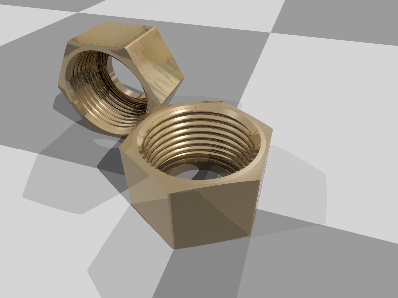

They are isosurfaces.  I'm thinking about modeling a few different types to create a
simple scene,
maybe to be used as a desktop background.  Criticisms and suggestions welcome.
Kyle

Good. My problem: the sides looks to thin. All the nuts that I have seen have
much thicker sides. Ether make the hole smaler or the body larger, keeping the
same hight.

Thanks.  They are models after faucet shank nuts, which have thin sides and a flat
area in the rear
with a smaller hole through it.

They look real tasty ;-)
I think the insides look amazing, and more work needs to be done on the
outside to make 'em look more metallic. Jaime Vives Piqueres has done a
nice 'bolts' render (http://www.ignorancia.org) with blurred reflections
AFAIR. Maybe you two should join forces ;-)

The threads look very impressive...

compression fitting nut then the end plate with the hole to take the pipe
hole should be a bit smaller. And a bit of scratching would not come amiss.
I would be interested to see the code for the isosurface.

very nice.
I did some thread iso's a while ago. :-)
http://news.povray.org/povray.binaries.images/thread/%3Cweb.4139722b2521c5a8399d8d0%40news.povray.org%3E/?mtop=8
the problem i had is that they don't look very good because the threads
don't have a rounded edge, so there is no highlight.

I really like the texture in the bolt rendering by Jaime.
http://www.ignorancia.org/en/index.php?page=Bolts_still
(I think he used a simple sphere sweep for the thread )
My own texture was a bit of a failure :-)
http://news.povray.org/povray.binaries.images/thread/%3Cweb.413aea09e929ab82a8399d8d0%40news.povray.org%3E/?ttop=235638

Thanks Jaap, I remember them. I don't agree that they don't look good, I like
them. I'll keep the link for when I get some time to play with Iso's.
BTW I prefer the ones with the sharp thread.
