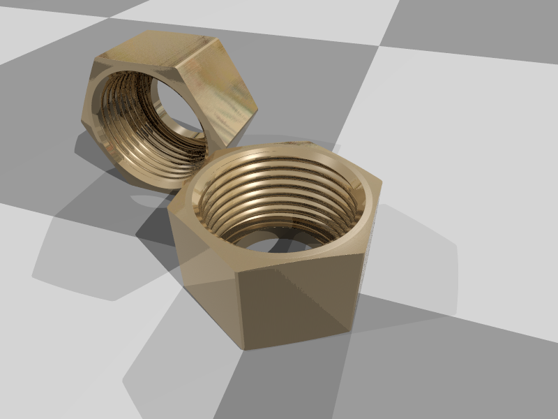

They are isosurfaces.  I'm thinking about modeling a few different types to create a
simple scene,
maybe to be used as a desktop background.  Criticisms and suggestions welcome.
Kyle

Good. My problem: the sides looks to thin. All the nuts that I have seen have
much thicker sides. Ether make the hole smaler or the body larger, keeping the
same hight.
>same hight.
Thanks.  They are models after faucet shank nuts, which have thin sides and a flat
area in the rear
with a smaller hole through it.
Kyle
simple scene,
> Kyle
They look real tasty ;-)
I think the insides look amazing, and more work needs to be done on the
outside to make 'em look more metallic. Jaime Vives Piqueres has done a
nice 'bolts' render (http://www.ignorancia.org) with blurred reflections
AFAIR. Maybe you two should join forces ;-)
> to create a simple scene,
> welcome.
> Kyle
The threads look very impressive...
> >same hight.
area in the rear
> Kyle
compression fitting nut then the end plate with the hole to take the pipe
hole should be a bit smaller. And a bit of scratching would not come amiss.
I would be interested to see the code for the isosurface.
Stephen

very nice.
I did some thread iso's a while ago. :-)
http://news.povray.org/povray.binaries.images/thread/%3Cweb.4139722b2521c5a8399d8d0%40news.povray.org%3E/?mtop=8
the problem i had is that they don't look very good because the threads
don't have a rounded edge, so there is no highlight.

I really like the texture in the bolt rendering by Jaime.
http://www.ignorancia.org/en/index.php?page=Bolts_still
(I think he used a simple sphere sweep for the thread )
My own texture was a bit of a failure :-)
http://news.povray.org/povray.binaries.images/thread/%3Cweb.413aea09e929ab82a8399d8d0%40news.povray.org%3E/?ttop=235638
&toff=2050

On Fri,  1 Dec 2006 10:04:48 EST, "Jaap" <jws### [at] yahoocom> wrote:
>very nice.
Thanks Jaap, I remember them. I don't agree that they don't look good, I like
them. I'll keep the link for when I get some time to play with Iso's.
BTW I prefer the ones with the sharp thread.
