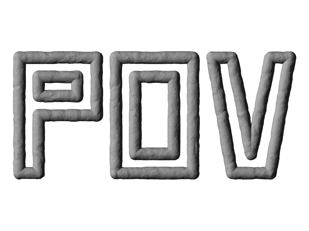

another example of sphere sweep as on iso
ABX
#declare _=function(a,b,x){((a^2)+(b^2))^.5-x}#default {pigment{color rgb 1}}
union{plane{y,-3}plane{-x,-3}finish{reflection 1 ambient 0}}isosurface{ //ABX
function{_(x-2,y,1)&_((x+y)*.7,z,.1)&_((x+y+2)*.7,z,.1)&_(x/2+y*.8+1.5,z,.1)}
contained_by{box{<0,-3,-.1>,<3,0,.1>}}translate z*15finish{ambient 1}}//POV35
Download 'test.png' (191 KB)

That's really excellent; have you posted the code?
I would like to try animating it...
Dennis
I could not spot any non-connected cylinder
ends in that image, so I thought that maybe
the source code below could be of interest
for you.
But maybe you have figured this out already...
Tor Olav

If you and Tor just put your heads together, we can all enjoy something like we
might find here:
http://www.softy3d.com
Looking forward to more. :)

not yet, I'm working on other linear types of segment (various radius at
begining and end of segment)
Please, wait a little
ABX
