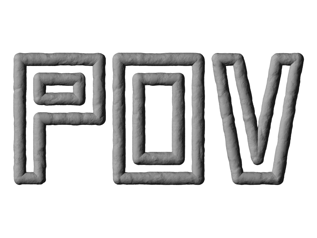

another example of sphere sweep as on iso
ABX
#declare _=function(a,b,x){((a^2)+(b^2))^.5-x}#default {pigment{color rgb 1}}
union{plane{y,-3}plane{-x,-3}finish{reflection 1 ambient 0}}isosurface{ //ABX
function{_(x-2,y,1)&_((x+y)*.7,z,.1)&_((x+y+2)*.7,z,.1)&_(x/2+y*.8+1.5,z,.1)}
contained_by{box{<0,-3,-.1>,<3,0,.1>}}translate z*15finish{ambient 1}}//POV35
Download 'test.png' (191 KB)

That's really excellent; have you posted the code?
I would like to try animating it...
Dennis
I could not spot any non-connected cylinder
ends in that image, so I thought that maybe
the source code below could be of interest
for you.
But maybe you have figured this out already...
Tor Olav

From: Tor Olav Kristensen
Subject: Re: iso-sphere-sweep - second example
Date: 4 Jan 2002 22:40:14
Message: <3C367532.90EB725D@hotmail.com>
Tor Olav Kristensen wrote:
> #macro CylinderFunction(pA, pB, Radius)
>   #local Ax = pA.x;
>   #local Ay = pA.y;
>   #local Az = pA.z;
>   #local vL = pB - pA;
>   #local Lx = vL.x;
>   #local Ly = vL.y;
>   #local Lz = vL.z;
>   #local LL = vdot(vL, vL);
>   #local vD = vL/LL;
>   #local Dx = vD.x;
>   #local Dy = vD.y;
>   #local Dz = vD.z;
>   #local AD = vdot(pA, vD);
>   function {
>     sqrt(
>       (x - Ax - max(0, min(x*Dx + y*Dy + z*Dz - AD, 1))*Lx)^2
>      +(y - Ay - max(0, min(x*Dx + y*Dy + z*Dz - AD, 1))*Ly)^2
>      +(z - Az - max(0, min(x*Dx + y*Dy + z*Dz - AD, 1))*Lz)^2
>    -Radius
> #end // macro CylinderFunction
If one includes functions.inc, then the
function above can be written like this:
function {
  f_sphere(
    x - Ax - max(0, min(x*Dx + y*Dy + z*Dz - AD, 1))*Lx,
    y - Ay - max(0, min(x*Dx + y*Dy + z*Dz - AD, 1))*Ly,
    z - Az - max(0, min(x*Dx + y*Dy + z*Dz - AD, 1))*Lz,
    Radius
This might render faster because of the use of
the internal sphere function, but I have not
found clear evidence of that yet.
Tor Olav

From:
Date: 7 Jan 2002 02:46:50
Message: <3gki3ucinlpobg8rnpluoj0dicfn5m1vo2@4ax.com>
On Fri, 4 Jan 2002 21:56:10 -0500, "Dennis Milller" <dhm### [at] mediaonenet>
Thank You.
not yet, I'm working on other linear types of segment (various radius at
begining and end of segment)
Please, wait a little
ABX
