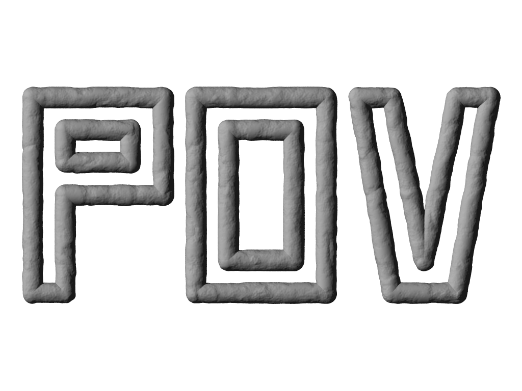

another example of sphere sweep as on iso
ABX
#declare _=function(a,b,x){((a^2)+(b^2))^.5-x}#default {pigment{color rgb 1}}
union{plane{y,-3}plane{-x,-3}finish{reflection 1 ambient 0}}isosurface{ //ABX
function{_(x-2,y,1)&_((x+y)*.7,z,.1)&_((x+y+2)*.7,z,.1)&_(x/2+y*.8+1.5,z,.1)}
contained_by{box{<0,-3,-.1>,<3,0,.1>}}translate z*15finish{ambient 1}}//POV35
Download 'test.png' (191 KB)
Preview of image 'test.png'
From: Dennis Milller
Subject: Re: iso-sphere-sweep - second example
Date: 4 Jan 2002 21:57:51
Message: <3c366baf$1@news.povray.org>
That's really excellent; have you posted the code?
I would like to try animating it...
Dennis

From: Tor Olav Kristensen
Date: 4 Jan 2002 22:35:02
Message: <3C3673FB.52F2CC76@hotmail.com>
I could not spot any non-connected cylinder
ends in that image, so I thought that maybe
the source code below could be of interest
for you.
But maybe you have figured this out already...
Tor Olav

not yet, I'm working on other linear types of segment (various radius at
begining and end of segment)
Please, wait a little
ABX
