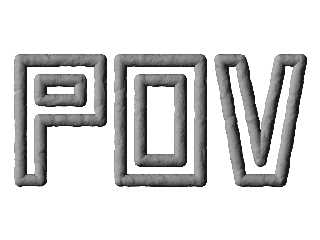

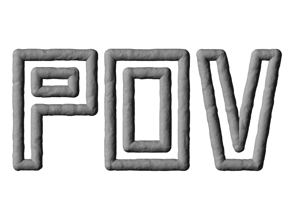

another example of sphere sweep as on iso

That's really excellent; have you posted the code?
I would like to try animating it...

I could not spot any non-connected cylinder
ends in that image, so I thought that maybe
the source code below could be of interest
for you.
But maybe you have figured this out already...
Thank You.
not yet, I'm working on other linear types of segment (various radius at
begining and end of segment)
Please, wait a little
> for you.
Thank You.
Yes, Your method is similiar to one of those tested by me. I have tested
different modifications and optimizations to speed up rendering time.
