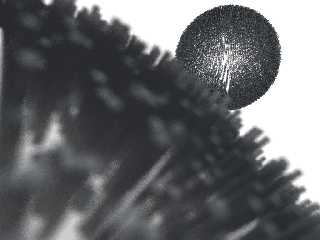

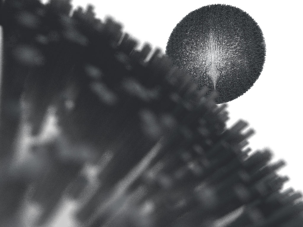

Hello, there.  This is actually my second time posting, so no reflecting
spheres today.
I was just playing around last night and did this nice little image with
the trace function, nested loops and spherical coordinates.  Basically, its
just a bunch of cylinders placed on a sphere.  Actually, 80800 cylinders.
Hope you enjoy it.  Took an hour to render...  Just an area light and focal
blur.
Matt Leonard
Download 'cylsphere.jpg' (118 KB)
Preview of image 'cylsphere.jpg'

Simple image, but artistic effect is interesting :)

I really like that grey, shiny look!
What formula did you use for tracing?  For a sphere, it wouldn't be
necessary to use trace at all, of course, but now that you have ... I wonder
if you also used some interesting formula for tracing all around the object
in question.

Cool idea!
I like the simple look of the image. The focal blur looks a bit grainy
though.
Florian

Basically all I did was trace out a sphere with the start of the trace
function.  Ummm...  when using spherical coordinates, you can describe a
sphere easily with three parameters, the radius, theta - the angle around
the vertical axis, and phi - the angle with respect to the horizontal
plane.  I just took one theta and moved phi down, scanning across the
surface of the sphere and placing cylinders.  Then it increments theta, and
scans down again.  Do this a bunch of times and you end up with the
picture.  Code looks like this:
#while ( theta < 2*pi )
    #local phi = 0;   #while ( phi < pi )      #local vary = rand(seed1);
      #local Start = <r*sin(phi)*sin(theta), r*cos(phi), r*sin(phi)
*cos(theta)>;  #local Inter = trace ( S, Start, <0,0,0> - Start, Norm );
cylinder { Inter, Inter + Norm*vary*.5, .025
      #local phi = phi + pi/Number;
    #end
    #local theta = theta + 2*pi/Number;
  #end
Probably more complicated than it needs to be, but whatever....
Thanks for the comments!
From: Matt Leonard
Subject: Re: A few cylinders [~117 KB]
Date: 15 Apr 2004 18:12:48
Message: <opr6iqnlaevka4sj@news.povray.org>
Uhhh...  the code didn't come out right...
#local Start = <r*sin(phi)*sin(theta), r*cos(phi), r*sin(phi)*cos(theta)>;
texture { T_Chrome_2B } }
#end
#end
Does this work?

Excellent feeling of depth!!!

Thanks for posting the code!
> but whatever....
Yes and no. If your loops are shooting rays from origin and outwards in a
spherical pattern, the trace function is superflous. You just need a length
parameter to act as stop condition.
Hugo

Very Nice, I like it, how about spheres on a cylinder!
