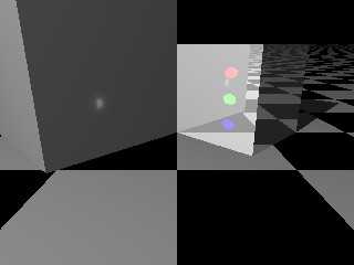

I've just started playing around with photons  (using POV3.5 Windows)
I'm getting unexpected results when using cylinder lights and photons,
I have 3 cylinder lights (red, green and blue) pointing at a
reflective box, the light 'beams' stike the box at a 45 degree and and
reflect onto another (non-reflective) box.
I would expect to get 3 distinct light patches on the non-refective
box. Instead they seem to converge on one area.
If I replace the lights with spot lights, I get the results that I
would expect.
I'm not sure if this is a bug, or a booboo on my part.
Below is the scene text that I used

From: Bruce D
Subject: Cylinder lights and photons, Bug? (1/1)
Date: 11 Jul 2002 15:49:07
Message: <t8oriuscuu24ni40gh0vp76sde71tgphga@4ax.com>
Download 'photontest_spotlight.jpg' (9 KB) Download 'photontest_cylinder.jpg' (8 KB)
Preview of image 'photontest_spotlight.jpg'
Preview of image 'photontest_cylinder.jpg'

Hi Bruce, yes, something weird has happened I think. I wasn't getting too
involved at all with the beta testing during the last stages but I do see
that now Scenes\Advanced\optics.pov has changed. I had used the cylinder
spotlight in that scene file to keep a check on photons in media and now it
only renders half the beams it used to do. Try it and you'll see what I
mean. Sorry, but I haven't a clue what is going on.

Thanks for the response, I have notice other odd things when using
cylinder lights with photons. Mainly incomplete 'beams' like in my
first example, or no photons being deposited at all.
But I must say, for me, photons is my favorite new feature in the
official pov. Until I try one of the others I suppose :)

Hey, um, well heck... I rechecked using scenes\advanced\optics.pov again but
this time I realized I made an incorrect presumption. The cylinder light
radius was insufficient to stretch across both openings in the wall it beams
through (it's a bit offset in the +z, camera at +y?). That's why it appeared
as if half the light beam was showing. So that wasn't a problem after all.
In order to see that indeed the cylinder spotlight can be reflected at
various angles and then shone upon a wall try this. Add:
plane {x,0 pigment {rgb 1} finish {diffuse 1} rotate -30*z translate 3*x}
 // or rotate -45*z
to the end of the optics.pov file. Maybe increase the spotlight color to 3
so that the beam appears bright and that way you don't miss the effect. The
media won't show unless you make the plane hollow or -x but it's much faster
to render that way anyhow.
Fact is, it can do what is expected. What happens in your scene file is a
mystery to me still. I put the same global photons in and tried a few other
things to see if I could get the correct result. Nothing. I'm baffled. Could
be something simple I'm overlooking but I spent longer than I expected just
to check on it again so I figured I had covered all the bases.
