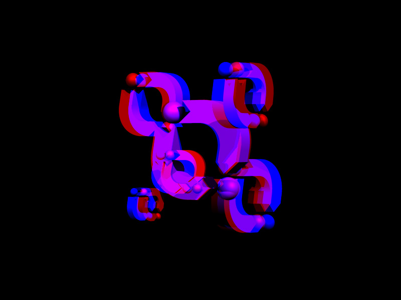

Seeing a recent discussion on anaglyphs, I wondered if we could make
them in a single render. I did a search and found a trick used to make a
stereo image, using mirrors. See "Dawn Patrol" in
http://www.irtc.org/stills/1998-02-28.html
It's a simple extension of that method to make an anaglyph. I have
attached the final result, with two diagrams to show how it was made.
(Please note the model changed a bit in between these renders.)

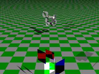

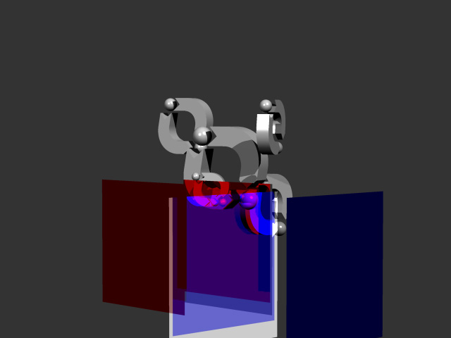

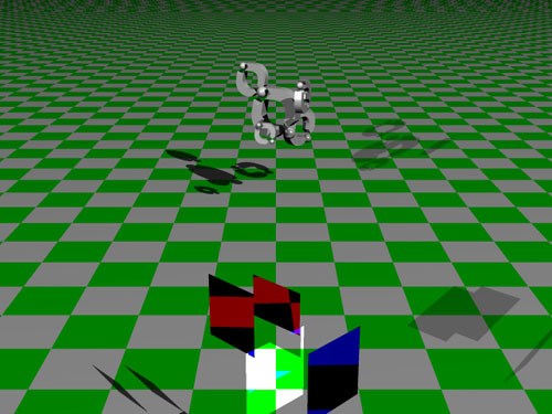

The picture with the checkered floor (put in just for clarity in this
picture) shows the optical system. There are four "special" mirrors:
- The bright one nearest us has transmit 1 and reflection 1. So it's a
povray supermirror, transmitting *and* reflecting 100% of the light.
- The one directly behind it is just a normal mirror.
- On the right of the supermirror is a "blue" mirror, reflecting only
blue.
- On the left of the plain mirror is a "red" mirror.
"anaglyph1.jpg" shows what happens when the camera looks through the
system. Note that the two mirrors in the centre are at 45 degrees to the
x-y plane. The coloured mirrors are tilted a little from 45 degrees,
such that when we look directly towards the object, the centre of the
blue and red images are coincident.
Please note that on the two explanatory figures, I have given the
mirrors some diffusion to make them visible. Also, I have put a grey
background in these cases.
