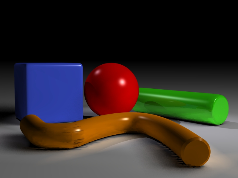

Well here is one of my 1st radiosity tests, and I have a couple of
questions....1st here is how I set my radiosity:
radiosity {
    brightness       3.3
    count            400
    distance_maximum 33.0
    error_bound      0.4
    gray_threshold   0.5
    low_error_factor 0.8
    minimum_reuse    0.015
    nearest_count    6
    recursion_limit  2
Ok so...can anyone help me understand where the blotchiness alonng the
underside of the tube might have come from....the bands along the
second bend from the right are confusing me as well.
The are two lightsources....a 7x7 (adaptive 4 jitter on) area light
scaled by 4 towards the front right and just below the camera, and a
spotlight placed above,  behind, and slightly left of the blue cube.
Any ideas will be most welcome....Thanks - Oldstench

From: Josh English
Subject: Re: Radiosity test question - radtest.jpg (0/1)
Date: 7 Sep 2000 16:44:59
Message: <39B7FE4A.7D958ABC@spiritone.com>
TonyB discovered that it was max_trace_level causing the blotchiness, but
that might only affect scenes with reflection or refractions.
Josh

eng### [at] spiritonecom
Date: 7 Sep 2000 16:52:31
Message: <39b8000f@news.povray.org>
"Oldstench" <SPA### [at] hotmailcom> wrote in message
news:evufrssnlb3v60oeni77urpn58dsu49ii7@4ax.com...
What's the tube made up of?  How was it created in other words.
And you seem to be using official POV-Ray.  Makes a big difference in how
radiosity is set up in MegaPov if you have that instead.
From: Oldstench
Date: 7 Sep 2000 16:59:30
Message: <9b0grs0m0t2i10s77repjak0tk1t693lnm@4ax.com>
On Thu, 7 Sep 2000 15:51:55 -0500, "Bob Hughes"
>Bob
The tube was modelled in Rhino and exported into moray as a .UDO. And
yes I am using official POV.... Should I be using MegaPov?
Date: 7 Sep 2000 17:08:14
Message: <39b803be@news.povray.org>
news:9b0grs0m0t2i10s77repjak0tk1t693lnm@4ax.com...
| >Bob
Ah ha, well then it might very well be a case of inside-out triangles, but I
don't really know much about that.
Yes, Megapov is the way to go when doing radiosity renders since you can
practically get by with simply a radiosity{} and ambient_light 0 in the
global_settings and not worry too much about the settings.  Defaults do
well.  Still need to invoke the radiosity as usual with a +qr on command
line or ini_option "+qr" in the global_settings block also.
From: Tony[B]
Date: 8 Sep 2000 01:05:41
Message: <39b873a5@news.povray.org>
Nathan 'discovered' it. I only put his discovery to use.
