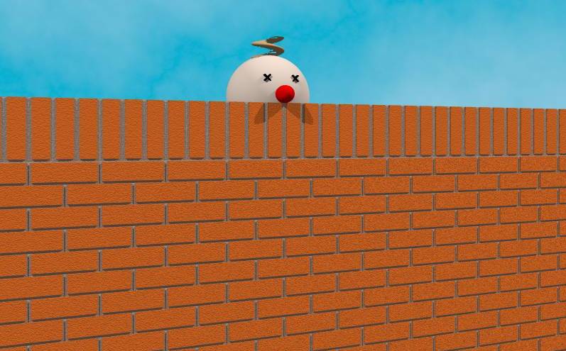

My first try at isosurfaces. Just a single pigment on the bricks and noise3d to
gives a rustic brick appearance.  There are plenty of brick wall macros around,
but they tend to have long rendering times so I thought I would try to devise an
Isosurface representation.  The functions used to create the recessed joints are
also used to define the pigment for the bricks and the mortar.
The code used in this wall is available on my website.
rendering time:-  800x600 aa 0.3  took 27m 21s on my PII 350
The character looking over the wall was popular in the UK in the 40s when
everything was in short supply, with the tag "Wot no ****"
Thanks to Quadhall for the spiral Isosurface and to Samuel T Benge and Mike
Williams for their Isosurface tutors.
dav### [at] hamiltonitecom
http://hamiltonite.com/
Download 'Boz_1.jpg' (57 KB)
Preview of image 'Boz_1.jpg'

This looks good, but the vertical section of mortar seems to have
a harsh/dark shadow that doesn't look right, I'm talking about
the lower section, not the top course of upended bricks which
doesn't have the shadow I'm talking about.

Looks like it's just the lighting making the shadows overlap.

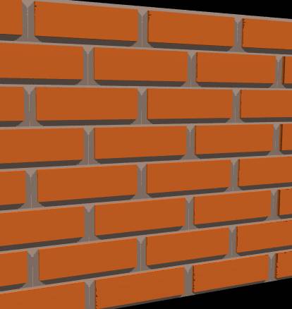

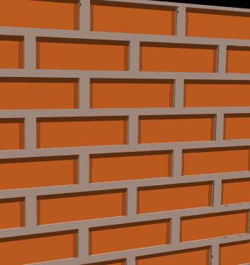

You're right David.  The first of the attached  images uses a wider joint to
avoid the overlap and show that the joint surface is complete.  The second image
shows the effect of  a negative depth of joint - good for POV Waffles?
Both images show that the isosurface is tending to have problems at the edge of
the bricks - not surprising as there is an instantaneous change of slope there.
Download 'IsoBrick2.jpg' (17 KB) Download 'IsoWaffle.jpg' (16 KB)
Preview of image 'IsoBrick2.jpg'
Preview of image 'IsoWaffle.jpg'
