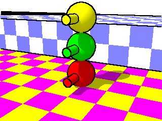

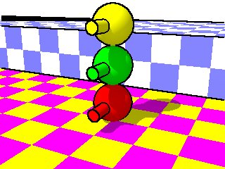

This one was inspired by the "cartoon" post process, although it doesn't
share any of that code.(Thanks to TonyB for getting me started on this!)
It finds the edges using two methods: finding sharp differences in
surface normal, and finding sharp differences in depth. It takes 3
parameters: a threshold for each of the edge finding algorithms, and a
line color. This is an example of the output of the filter:

Could you be more specific about the parts that need work?
The one thing I see is the poor control of line thickness, I have a
couple ideas for counteracting that, but I haven't tried any of them yet.

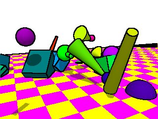

Here is another demo image of this filter, a bunch of randomly placed
cones, spheres, and boxes. Next, I am going to work on finding the edges
between colors.
Christopher James Huff - Personal e-mail: chr### [at] yahoocom
Personal Web page: http://chrishuff.dhs.org/

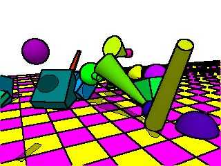

And here is the version including color edge detection:
Download 'find_edges2b.jpg' (31 KB)
Preview of image 'find_edges2b.jpg'
