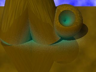

This is my first success with my visibility pattern. It is supposed to
be copper or a copper alloy with a patina on it, worn away in exposed
areas. The syntax is simple, this is the code that produced this image:
#declare TestObj=
union {
   box {<-5,-1,-5>, < 5, 0, 5>}
   cylinder {< -2, 0, 0>, <-1, 3, 0>, 1}
   cylinder {< 0, 0, 0>, <-1, 3, 0>, 1}
   difference {
      sphere {< 1, 1, 0>, 1}
      cone {< 1, 1, 0>, 0, < 1, 1.75,-1>, 0.65}
object {TestObj
   texture {
      pigment {color rgb < 0.6, 0.45, 0>}
      finish {
         reflection 0.35
         reflect_metallic
         metallic
         ambient 0 diffuse 0.6
   texture {
      pigment {visibility 200, object {TestObj}
//visibility SAMPLES, TARGET_OBJECT
         color_map {
            [0 color rgb < 0.15, 1, 0.75>]
            [0.1 color rgb < 0.15, 1, 0.75>]
            [0.6 color White transmit 1]
            [1 color White transmit 1]
Time For Trace:    0 hours 11 minutes  26.0 seconds (686 seconds)
On a PowerPC G3 at 266MHz.
I had to make the object be specified as a parameter, otherwise it
didn't work with CSG objects. I am not sure why, though. And a possible
problem with this syntax: although it gives you more control over the
objects that affect the pattern, you can't just define a texture and
have it work for all objects. :-(
Chris Huff
e-mail: chr### [at] yahoocom
Download 'visibility.JPG' (8 KB)
Preview of image 'visibility.JPG'
Couldn't you just make two separate versions? One for non-CSG and one for
that specific purpose? Could you make an example with an isosurface? Oh, and
why didn't you name it "patina"?

I just coded the necessary changes to make the object parameter
optional, it uses the object it is applied to when it isn't specified.
I could. I haven't tested it with an isosurface yet, I hope it doesn't
interact badly with the solving method.
> Oh, and why didn't you name it "patina"?
Because it can be used for more than just patinas. It can be used for
anything that can be worn off: paint, maybe accumulations of dust, it
might be good for landscapes....
Another good name might have been accessibility.

Although I certainly like what you're doing I wanted to ask if this is just
plain impossible as a texture pattern type of thing instead of a kind of media
sampling method which you are apparently trying out here.
It's the scattered look to the partial places that bothers me, if this were to
be considered a patina or similar then a smooth transition zone would probably
be considered best.
As is at least it could be faked well for more distant or smaller objects.

I am not sure what you mean here...this is an ordinary texture, no media
used. The sampling really has more in common with blurred
reflection/transparence, it isn't much like media. It shoots rays in a
hemisphere(so rays are not shot into the object) on the surface of the
object and returns the percentage of them that hit the object.
> this were to be considered a patina or similar then a smooth
> transition zone would probably be considered best. As is at least it
Using more samples would smooth it out, and there might be ways to use
the samples other than just calculating the percentage that hit that
would give smoother results.

In your code I don't see any limit on the direction the sample rays
are shot. I think it would be useful if one could specify a maximum
angle that the sample rays can form with the plane tangent to the
evaluated point. The minimum should of course be 0 because for all
angles below that the sample rays will hit the surface infinitesimally
close to the evaluated point. And the maximum angle is needed to save
the overhead of taking samples straight up when the greatest slope on
the surface is 1/1000. I hope I explained this well, I will illustrate
it with an image if you want.

Yes, I am planning on adding those sort of controls later. This was just
my first working version...there is actually code for part of it(minimum
angle) that is currently commented out and a bit incomplete. This will
probably be the first thing I do when I get back to working on this
patch(I am currently working on a particle simulator, in C++).
