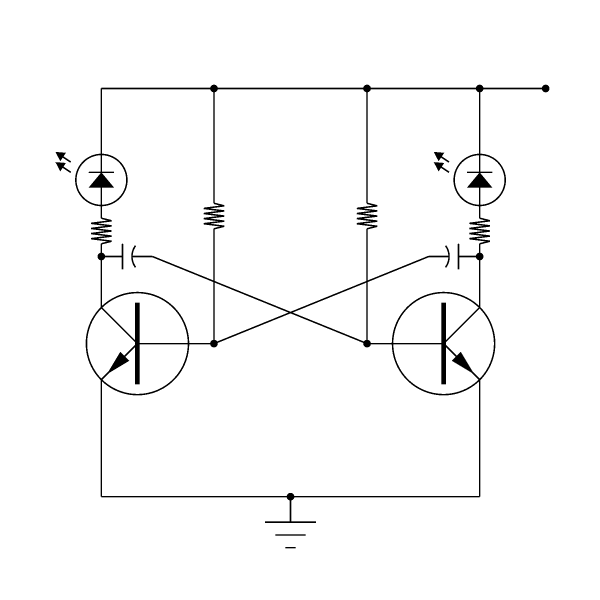

This is definitely an example of the extent to which POV can be
mis-used...
Combining two of my hobbies, I've created a small include file that lets
you generate schematic diagrams of electronic circuits with POV-Ray. It
is basically a set of macros for making wires and component symbols.
It can currently draw:
NPN and PNP bipolar transistors
resistors
nonpolar and polar (electrolytic) capacitors
rectifier diodes
zener diodes
LEDs (Light Emitting Diodes)
Ground symbol
Wire connections
It can also automatically fit the schematic to the output image,
optionally leaving a blank margin area...if a component moves outside
the visible range, the entire schematic is scaled down until it fits,
while maintaining the proper aspect ratio. I also plan to add an
automatic labelling feature. Also, the schematic is currently done as a
texture on a box (using my object pattern patch), I will also try using
separate objects...that may be slower rendering, since POV will have to
do actual intersection calculations. Also, since it uses min_extent()
and max_extent, and the object pattern, it requires MegaPOV.
While it is probably useless for designing circuits, it could be useful
for illustrating them...it makes it easy to generate nicely anti-aliased
images at any resolution.
This is just a simple astable multivibrator LED flasher circuit. I used
a PNG because it wasn't any smaller as a JPEG, and JPEG left artifacts
visible.
Christopher James Huff
Download 'Multivibrator.png' (14 KB)

Hey, that's cool, and definitely not a mis-use of POV. It just shows how
versatile it is. :)

The basic circuit (the two transistors linked together with capacitors)
is a pretty common building block, so it's not surprising that you have
seen it before if you have done anything at all with electronics.
> Now what would be really cool is if you could take a circuit diagram,
> and have it render a circuit board with accurate resistor color
> codes, and everything.  I'm sure people would pay money for that.
I'm sure people *do* pay money for software that does that...but I have
no idea how to do it. I'm having a hard enough time getting labels to
align properly. Doing something that used models of the parts would be
fairly easy, but the board traces would be next to impossible.

From: Chris Huff
Subject: Re: Electrical schematics include - Multivibrator.png (1/1)
Date: 22 Feb 2001 18:20:16
Message: <chrishuff-4168E1.18192122022001@news.povray.org>
In article <3A959023.DEC3722F@hotmail.com>, Dan Johnson
<zap### [at] hotmailcom> wrote:
> Hey just found something that might be in interest.  A finished circuit
> board, and schematic made in povray.
> http://ourworld.compuserve.com/homepages/Alf_Peake/PC-BOARD.JPG
I remember seeing that before...I think it was posted here.
Hmm, what is it? (Mr. Peake, you reading this?)
The bridge rectifier, large capacitors, and 7808 voltage regulator make
a regulated 8V power supply that takes an AC input, and there seems to
be an option to use a battery as a power source as well, but I don't
recognize the 8-pin DIP IC. That and the other components don't look
like they belong on a power-supply board. There is something labelled
"door"...maybe a trigger for a garage door opener, or an alarm for when
a door gets opened, or a doorbell. The last two make the most sense...
I think he used image_maps for the part numbers and art, and maybe a
height_field for the copper traces (it looks slightly raised)...that
kind of stuff would be a lot easier now, you could use the object
pattern and create a set of macros that makes a generic IC, capacitor,
transistor, etc. and puts the specified text/other art on it, instead of
redoing much of it for each new part. And the schematic looks like it
was hand drawn, then scanned in as 1-bit color.
BTW, I have thought about it some more, and I think it would be possible
to do a simple kind of PC board layout with my macros...it would be
limited to a single-sided board, you would have to manually place
jumpers where the traces need to cross, and the layout of the components
would follow the layout of the schematic, which is rarely the best way
to do things and means you may have to adjust things to make sure
components don't intrude on each other's space, but it should work. I'll
save it for version 2, though...
