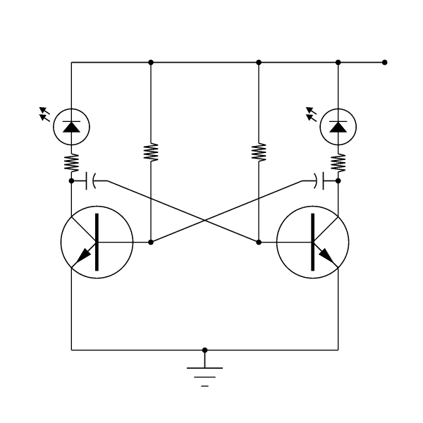

This is definitely an example of the extent to which POV can be
mis-used...
Combining two of my hobbies, I've created a small include file that lets
you generate schematic diagrams of electronic circuits with POV-Ray. It
is basically a set of macros for making wires and component symbols.
It can currently draw:
NPN and PNP bipolar transistors
resistors
nonpolar and polar (electrolytic) capacitors
rectifier diodes
zener diodes
LEDs (Light Emitting Diodes)
Ground symbol
Wire connections
It can also automatically fit the schematic to the output image,
optionally leaving a blank margin area...if a component moves outside
the visible range, the entire schematic is scaled down until it fits,
while maintaining the proper aspect ratio. I also plan to add an
automatic labelling feature. Also, the schematic is currently done as a
texture on a box (using my object pattern patch), I will also try using
separate objects...that may be slower rendering, since POV will have to
do actual intersection calculations. Also, since it uses min_extent()
and max_extent, and the object pattern, it requires MegaPOV.
While it is probably useless for designing circuits, it could be useful
for illustrating them...it makes it easy to generate nicely anti-aliased
images at any resolution.
This is just a simple astable multivibrator LED flasher circuit. I used
a PNG because it wasn't any smaller as a JPEG, and JPEG left artifacts
visible.
Christopher James Huff
Download 'Multivibrator.png' (14 KB)
Preview of image 'Multivibrator.png'

Hey, that's cool, and definitely not a mis-use of POV. It just shows how
versatile it is. :)

The basic circuit (the two transistors linked together with capacitors)
is a pretty common building block, so it's not surprising that you have
seen it before if you have done anything at all with electronics.
