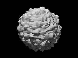

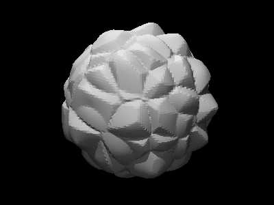

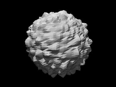

These macros generate height field meshes from pigments from within POV.
SquareHF.jpeg is an ordinary square height field, like the
height_field {} primitive object in POV.
SphereHF.jpeg is the first type of spherical height field, using a 2D
square wrapped around a sphere with spherical coordinates.
Sphere2HF.jpeg is the second type of spherical height field, generated
by recursively subdividing an octahedron, dividing each triangle into 4
triangles. This doesn't have the "pinching" toward the y axis like the
first type does.

Looks very interesting, although i did not yet totally understand how the
second and third one work, are you evaluating the pigment in a 2d plane or
in 3d space?
The third one looks similar to a sphere-crackle isosurface, that lead me
to the idea of an isosurface tesselation macro.  Since Warp's tesselation
patch is still buggy and does not work well on isosurfaces, that could be
quite useful IMO.

3D space, the surface of a 1-unit-radius sphere centered at < 0, 0,
0>...you could map the sphere to a 2D plane with the spherical warp, if
you wanted, but this method lets you get completely smooth, continuous
results.
