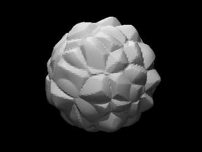

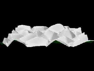

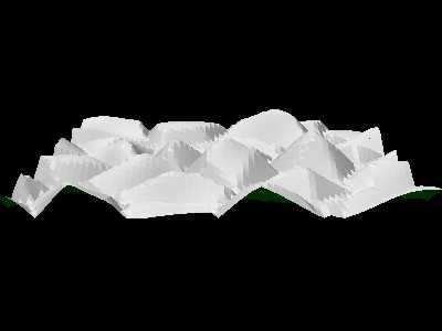

These macros generate height field meshes from pigments from within POV.
SquareHF.jpeg is an ordinary square height field, like the
height_field {} primitive object in POV.

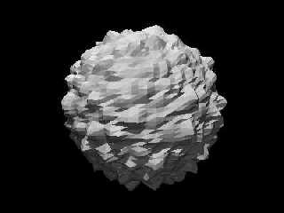

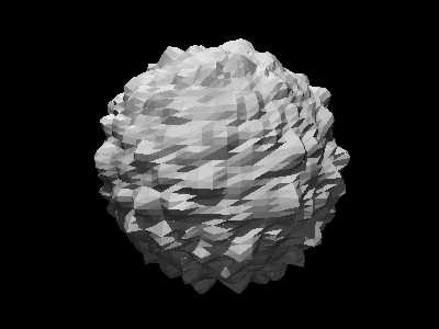

SphereHF.jpeg is the first type of spherical height field, using a 2D
square wrapped around a sphere with spherical coordinates.
Sphere2HF.jpeg is the second type of spherical height field, generated
by recursively subdividing an octahedron, dividing each triangle into 4
triangles. This doesn't have the "pinching" toward the y axis like the
first type does.
I still haven't done smoothing, I'll try to figure out a good way to do
it.
Christopher James Huff
Download 'SquareHF.jpeg.jpg' (6 KB) Download 'SphereHF.jpeg.jpg' (9 KB) Download 'Sphere2HF.jpeg.jpg' (6 KB)
Preview of image 'SquareHF.jpeg.jpg'
Preview of image 'SphereHF.jpeg.jpg'
Preview of image 'Sphere2HF.jpeg.jpg'

Cylindrical and spherical height fields are a MegaPOV feature, right?  I
didn't realize there was any kind of default height_field {} object, but
that's very interesting as well.  Did you use the smooth command in the
height_field?  Maybe you could increase the resolution of your height_field
image (if you used one.... I'm a little unclear exactly what you've done
here, but it's very interesting).
Stephen

Subject: Re: Height field macros - attached files (1/1)
Date: 3 Mar 2001 17:17:19
Message: <3AA16D6D.72C85D84@gmx.de>
> first type does.
> it.
Looks very interesting, although i did not yet totally understand how the
second and third one work, are you evaluating the pigment in a 2d plane or
in 3d space?
The third one looks similar to a sphere-crackle isosurface, that lead me
to the idea of an isosurface tesselation macro.  Since Warp's tesselation
patch is still buggy and does not work well on isosurfaces, that could be
quite useful IMO.

In article <3AA16D6D.72C85D84@gmx.de>, Christoph Hormann
> in 3d space?
3D space, the surface of a 1-unit-radius sphere centered at < 0, 0,
0>...you could map the sphere to a 2D plane with the spherical warp, if
you wanted, but this method lets you get completely smooth, continuous
results.
> quite useful IMO.
This would be extremely slow as a macro or include...maybe too slow to
be practical. Also, as I recall, Warp's tesselation patch works fine
with isosurfaces using method 2, and the problem with method 1 is
actually with the isosurface object itself, not the tesselation patch.
There is that odd bug with missing/misarranged triangles, but that often
doesn't pop up.
From: Chris Huff
Date: 3 Mar 2001 22:38:10
Message: <chrishuff-359426.22352703032001@news.povray.org>
In article <3aa16d04$1@news.povray.org>, "Stephen Bell"
No.
> I didn't realize there was any kind of default height_field {}
> object, but that's very interesting as well.
The height_field {} object only does "square patch" height fields.
> Did you use the smooth command in the height_field?
"I still haven't done smoothing, I'll try to figure out a good way to do
it."
Your question seems a bit odd, though...no, I didn't use the smooth
command, I didn't even use the height_field object. These macros
generate meshes.
> Maybe you could increase the resolution of your height_field image
No image was used, just a simple crackle pigment.
