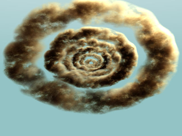

"Mick Hazelgrove" <mic### [at] mhazelgrovefsnetcouk> wrote in
news:3d8cb5f1@news.povray.org
> Attached is a pic with isosurface torii distorted with noise3d and
> filled with meda. There are bright white artifacts at the edges of the
> containers.

----- Original Message -----
From: "Mick Hazelgrove" <mic### [at] mhazelgrovefsnetcouk>
> Prob 1 anyone got any idea how to get rid of them
Prob 1 & 3
The following seems to work :
- use a regular torus with a larger inner radius
torus{RMax,RMin*2
- and then clamp the density function
density {function { min(max(fn_X(x, y, z),0),1) }
It must have been a coincident surface problem.
It solves the scaling problem too, and it's faster !
Prob 2 : where do you use eccentricity? All I see is media type 2...
Nice clouds btw. Are you making a POV-Ray version of Gulliver's Travels ?
G.

Hi
Thought I'd cancelled this message! I've managed to solve the problems I had
though I like the clamping function - works a treat!. The pic is going to be
the basis for an image on the phoenix bird, which, I am currently modelling
in Rhino.
