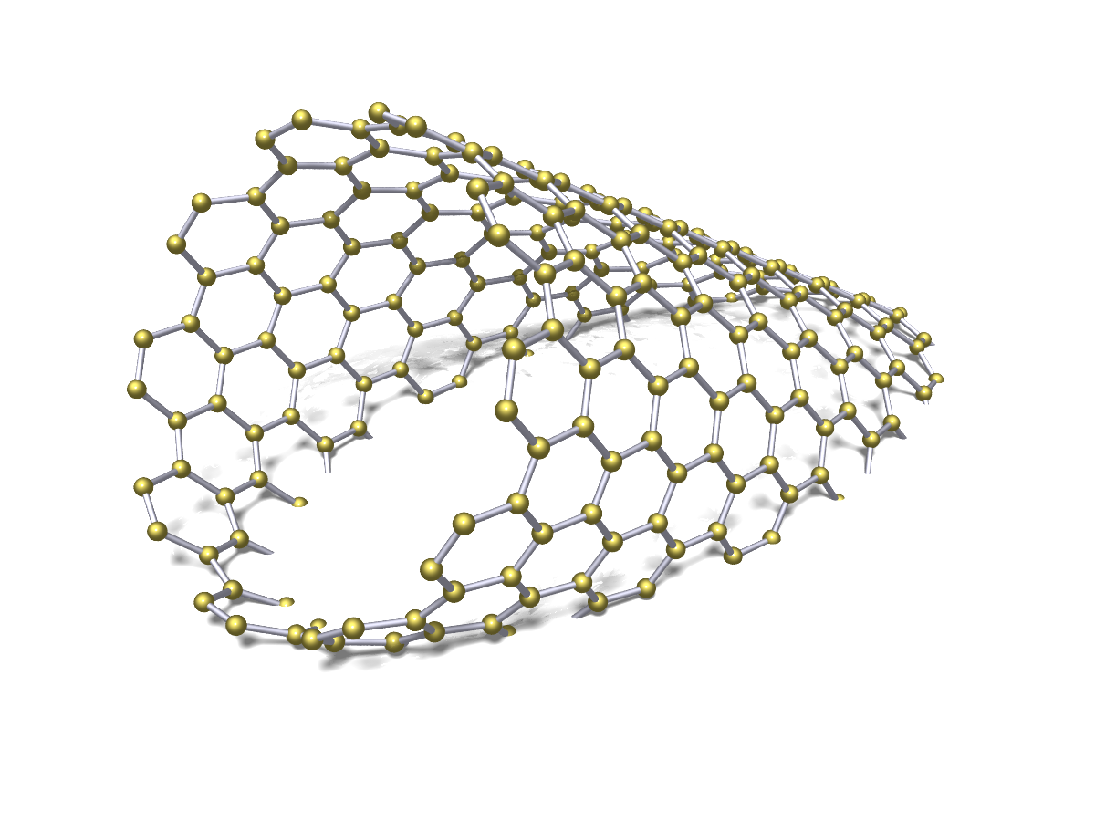

Hello,
My first attempt with nanotubes.
I don't know if that's "chemically" correct.
I've always been pretty bad at that stuff.
But I think it makes for a nice picture.
Happy Easter weekend
kurtz le pirate

On 4/4/26 18:41, kurtz le pirate wrote:
> Hello,
    Is this a pure geometric abstraction or a model
    derived from real datas/formulas ?
    Remember of an old experiment :)
           http://la.buvette.org/POV/FromOBJ/p/
    May be, I can revive this project one day or other ?
    Thanks, I've got a nice sun over my home for this w-e.

Le 2026-04-04 à 12:41, kurtz le pirate a écrit :
> Hello,
That's pretty much the actual structure of a real nanotube.
Agree.
This should be chemically correct. *
* there is a certain strain energy that cannot be exceeded for stable molecules.
So, as long as your nanotube has a certain minimum radius, then it should be
fine.   That's not to say that they've actually made/discovered on of that exact
size, just that there's nothing obviously wrong with the theoretical structure.
Usually when making things like this, there are the fundamental thermodynamic
considerations (is it stable?) but there can be overriding kinetic realities
that control what actually happens. (Structure A is less stable but forms
faster, so it out-competes structure B and winds up unexpectedly being the major
reaction product.)
The only other thing that's "missing" is the filling of the empty valence
orbitals on those dangling edge carbons.   What is at the edge of a crystal?
This is where a lot of interesting research goes on in the field of surface
chemistry.
You could also likely terminate those sites with methyl groups, alkenes (double
bonds) or some sort of aldehyde, ketone, or carboxylic acid.
You can also "dope" nanotubes with small quantities of other elements to replace
some of the carbons - boron, nitrogen, silicon, ... to imbue them with various
useful properties.
- BE
> reaction product.)
> chemistry.
> useful properties.
> - BE
I should have guessed as much when I saw your email. You’re a true
chemist for whom certain concepts are obvious but remain a bit abstract
for others—at least for me. In any case, your explanations are
“relatively” simple and offer some good insigh.
In this image, at least, the nanotube is just a pretext for exploring
and applying a few mathematical transformations.
kurtz le pirate
