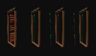

From: William F Pokorny
Subject: Re: Other things the text object can do.
Date: 19 Mar 2025 02:25:16
Message: <67da634c$1@news.povray.org>
On 3/4/25 10:35, William F Pokorny wrote:
> I started looking at a yuqk version of documentation for the text{} object.
Playing with the thickness parameter.
I've always specified values >0, but it works with values at 0 and with
negative values. With the latter though, by intent or mistake, only
renders the front and back surfaces - and the interior exterior
treatments are interesting / different(*).
Iideally we'd have an 'open' capability with text{}, but the way the
negative thickness values are working allows us to somewhat easily add
front and back surface textures which are different than the text{} sides.
The images use an 'interior_texture{}' that is green for the "What the
heck" string. Only matters with the negative thickness on the third and
fourth sub images. The fourth also using 'inverse'.
Bill P.
(*) Jerome contributed fixes to v3.8 which stabilized the interior /
exterior surface treatments for text{} objects with +z thicknesses. This
means prior versions will behave differently.
Download 'textthicknessstory.png' (85 KB)

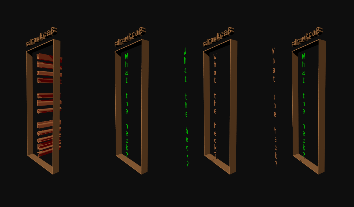

OK. Attached a sample image for many of the text{} updates coming in
release R19 of the yuqk fork. Namely, new text{} features 'caps' and
'open' along with fixes for negative thickness specifications. Negative
thickness becomes an OK thing to do and not something which only partly
works.
Bill P.
Download 'caps_open_features.png' (78 KB) Download 'caps_open_features.pov.txt' (5 KB)
Preview of image 'caps_open_features.png'
