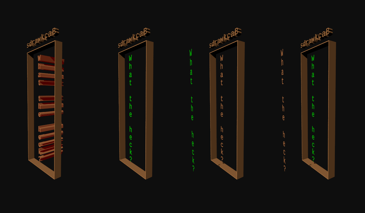

On 3/4/25 10:35, William F Pokorny wrote:
> I started looking at a yuqk version of documentation for the text{} object.
Playing with the thickness parameter.
I've always specified values >0, but it works with values at 0 and with
negative values. With the latter though, by intent or mistake, only
renders the front and back surfaces - and the interior exterior
treatments are interesting / different(*).
Iideally we'd have an 'open' capability with text{}, but the way the
negative thickness values are working allows us to somewhat easily add
front and back surface textures which are different than the text{} sides.
The images use an 'interior_texture{}' that is green for the "What the
heck" string. Only matters with the negative thickness on the third and
fourth sub images. The fourth also using 'inverse'.
Bill P.
(*) Jerome contributed fixes to v3.8 which stabilized the interior /
exterior surface treatments for text{} objects with +z thicknesses. This
means prior versions will behave differently.
This is all pretty interesting - especially using "inverse"  I always forget to
try and use that in things.
I do notice that there is something - a shadow? - present in the two rightmost
images that are not present in the two leftmost.  Significant in any way?
- BW
No. I think they are showing up where they should be(*).
Bill P.
(*) For the moment, let's ignore the fact I often get things wrong. :-)

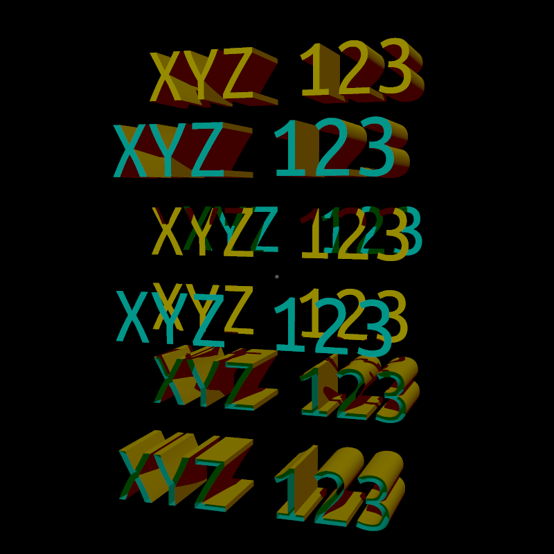

OK. Attached a sample image for many of the text{} updates coming in
release R19 of the yuqk fork. Namely, new text{} features 'caps' and
'open' along with fixes for negative thickness specifications. Negative
thickness becomes an OK thing to do and not something which only partly
works.
Bill P.

From: Bald Eagle
Subject: Re: Other things the text object can do.
Date: 25 Mar 2025 08:20:00
Message: <web.67e29f3a9216b80b6563700825979125@news.povray.org>
> works.
This is really cool, and actually very useful.
I often need to apply text to an image, but have to juggle the color depending
upon what color/brightness the background is.  Now we can have 2 contrasting
colors in a single glyph so that it always shows up reasonably well.
It will be interesting to experiment with things like gradients and other
patterns.
Now that you're neck-deep in the font code, can you ramble on about what you've
discovered / know about?
How difficult would it be to access the fundamental Bezier spline control points
for ttf fonts?
Can you make text render a tight spline rather than a thick outline?  A
"center-line" font?
Are these things dependent on how the font is defined in the file?
- BW

From: William F Pokorny
Date: 25 Mar 2025 14:18:21
Message: <67e2f36d$1@news.povray.org>
I'll soon post the first draft of the yuqk text{} documentation to:
   https://news.povray.org/povray.pov4.discussion.general/
> for ttf fonts?
Easy-ish to hack something. To do well, I don't know. Plus, I have
serious doubts that such font features fit well within POV-Ray. The font
(and font application) game as a whole is big and messy.
So, it's ttfdump, and similar external tooling for now.
> "center-line" font?
They are. Creating center line / offset splines automatically is not
easy (or even always possible) to do. IIRC, clipka mentioned 'stroke
fonts' exist, but I've had no exposure to them.
Your questions touch on an interesting topic. Namely, additional ttf
fonts designed specifically for POV-Ray use as building block shapes.
I'd probably start with a square aspect ratio, box character font.
Adding rounded corner shapes and the like to it too.
Thank you for the references in your follow-on post. I've stored them in
my BillW directory for later use.
Bill P.
