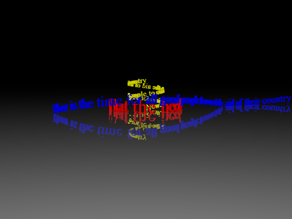

Aah!  In the meantime, I went down a rabbit hole and essentially did the same
thing...
See: https://github.com/carath63/povlibrary
library/libtext.inc
Examples/text_test.pov
Here is an example of using that technique to lay out text around a cylinder, up
a helix, and following a spline.  The spline relies on how close your the
distance between letters lines up with the distance between spline points.  As
you can see, it didn't work very well once the letters moved around the front
curve of the spline.  Still trying to figure out how to fix that.
-- Chris R
Download 'text_test.png' (98 KB)
Preview of image 'text_test.png'

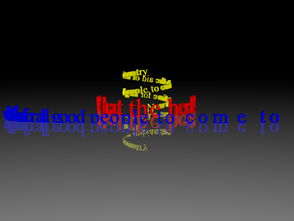

To prove my spline layout code is correct, I created some tools for converting a
spline whose values have an arbitrary range into a spline whose values go from
0.0 to the computed length of the spline over the given range of values.  Using
a spline that has been tuned this way gave a much better result in laying out
the text.
-- Chris R
Download 'text_test.png' (85 KB)

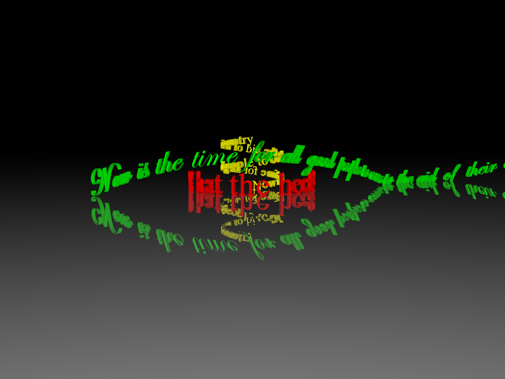

Time to move on, but here's the previous image using the new macro using
Spline_Trans with a Banking value of 1.0.  I used a more interesting font as
well.  The banking is subtle, but you can see it on the downward curve around
the "good people" section.
-- Chris R
Download 'text_test.png' (95 KB)
