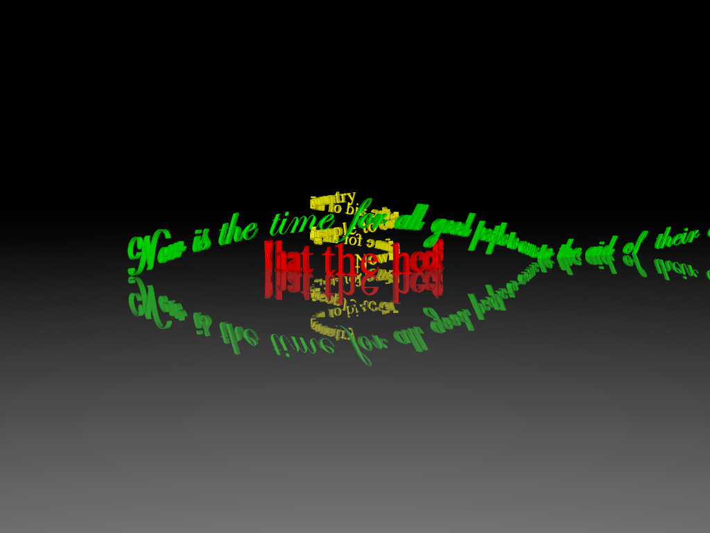

Aah!  In the meantime, I went down a rabbit hole and essentially did the same
thing...
See: https://github.com/carath63/povlibrary
library/libtext.inc
Examples/text_test.pov
Here is an example of using that technique to lay out text around a cylinder, up
a helix, and following a spline.  The spline relies on how close your the
distance between letters lines up with the distance between spline points.  As
you can see, it didn't work very well once the letters moved around the front
curve of the spline.  Still trying to figure out how to fix that.
-- Chris R
Download 'text_test.png' (98 KB)
Preview of image 'text_test.png'

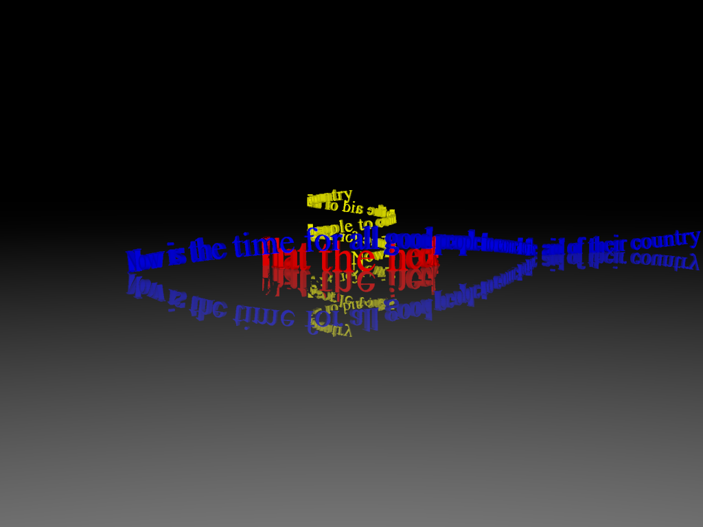

To prove my spline layout code is correct, I created some tools for converting a
spline whose values have an arbitrary range into a spline whose values go from
0.0 to the computed length of the spline over the given range of values.  Using
a spline that has been tuned this way gave a much better result in laying out
the text.
-- Chris R
Download 'text_test.png' (85 KB)

> I knew in the back of my head that I had used the Spline_Trans macro before, but
> couldn't remember what it was called or where it was.  Thanks!
> I'll probably create a new version of my Text Spline alignment macro and replace
> my code for computing the rotations with this, which allow for banking the text
> as well, which would be cool.
> The macro still has to do the work of computing the offset based on the letter
> spacing, and then using this macro to do the placement and orientation.  And I
> haven't seen anything equivalent to the code I wrote to convert a Spline using
> arbitrary values with a Spline that uses distances along the spline curve for
> values, so I think that's still useful.
> -- Chris R
Time to move on, but here's the previous image using the new macro using
Spline_Trans with a Banking value of 1.0.  I used a more interesting font as
well.  The banking is subtle, but you can see it on the downward curve around
the "good people" section.
-- Chris R
Download 'text_test.png' (95 KB)
