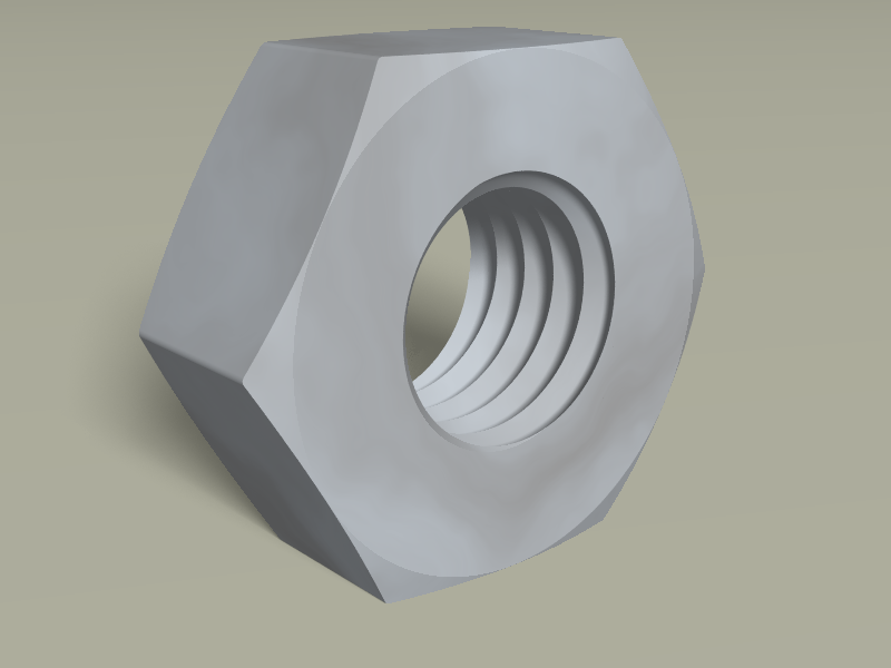

Hello,
Quickly make a small nut.
But i can't see that the thread is helical.
How do you see it?
Kurtz le pirate
> How do you see it?
If you look at the bottom of the hole, you'll see where the thread tapers off.
If you want to accentuate that, if you're using a difference {}, then you could
use a slightly different pigment color, or a normal.
You could even just change the lighting and cast a harsher shadow.
- BW

On 8/2/2024 7:36 AM, kurtz le pirate wrote:
> Hello,
> How do you see it?
I see it clearly in the hole, and a little bit on the front. Maybe
rotate it 60 degrees so the end points of the helix are in frame.
-- Uncle Josh

Le 2024-08-02 à 10:36, kurtz le pirate a écrit :
> Hello,
> How do you see it?
Almost see it. Slightly rotating that nut could probably make it more
visible. Maybe just a 15° to 30° clockwise rotation would be enough.
Then, shifting the light's location could also help.
Finally, the thread is often more shiny than the exterior of the nut.
That may also help.

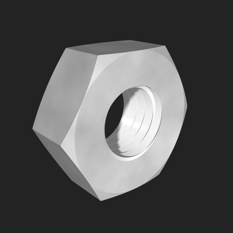

hi,
indeed, by working on the light, it's more obvious
thank you for your advice.
after all, it's just a nut...
Kurtz le pirate
