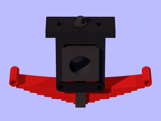

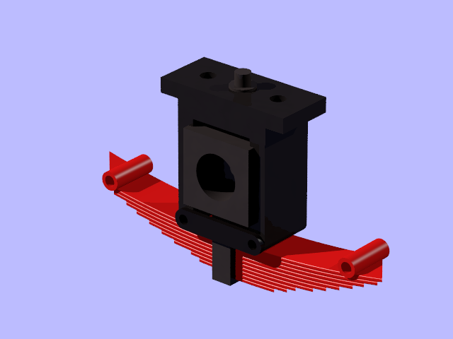

I made this leaf spring using segments of a rounded tube.
It looks fine when viewed straight-on but assumes a funny angle at the
ends when viewed from the side.
What is going on?

I've not tested it, but try adding:
clipped_by { bounded_by }
after each bounded_by{} statement.
Or, as Cousin Ricky recently suggested, in place of manual bounding
create each spring leaf as an intersection of a 'bounding box' with each
rounded tube.
Bounding - whether added manually or automatically - is only used to
determine whether the real 'ray -> shape/surface' intersection code for
the basic shape is run(a). In other words, ray -> surface intersections
'can be' outside the bounding.
Bill P.
(a) - Yes, with manual bounding you can intentionally set up visual
effects depending on how rays interact with the bounded_by shape(s). For
example, the bounded_by shape(s) need not surround the actual
shape/surface at all(b).
(b) - In official releases, manually playing with bounding is limited as
there is code which prevents users from making bounding smaller by
volume... In the povr fork that code is completely gone - IIRC. I think
it wrong for POV-Ray to secretly ignore user bounding (some auto
bounding too IIRC) based on a 'bounding volume can never be smaller than
what already exists' test. Yes, users might screw things up more often -
let 'em.

You are incorrectly using bounded_by as an alternative for an intersection.
ANY ray that hit the bounded_by shape will cause the bounded_by object
to be evaluated, even if that part is actually outside the bounded_by
object. Even if that part is in front of the bounded_by shape.
Instead, you should use an intersection or add clipped_by{bounded_by}
The first will close the object. You see the surface of the intersecting
object.
The second will leave the ends open. Adding an interior_texture will
make it obvious.

Thanks Alain and Bill P - intersection fixed it :-)
m@
