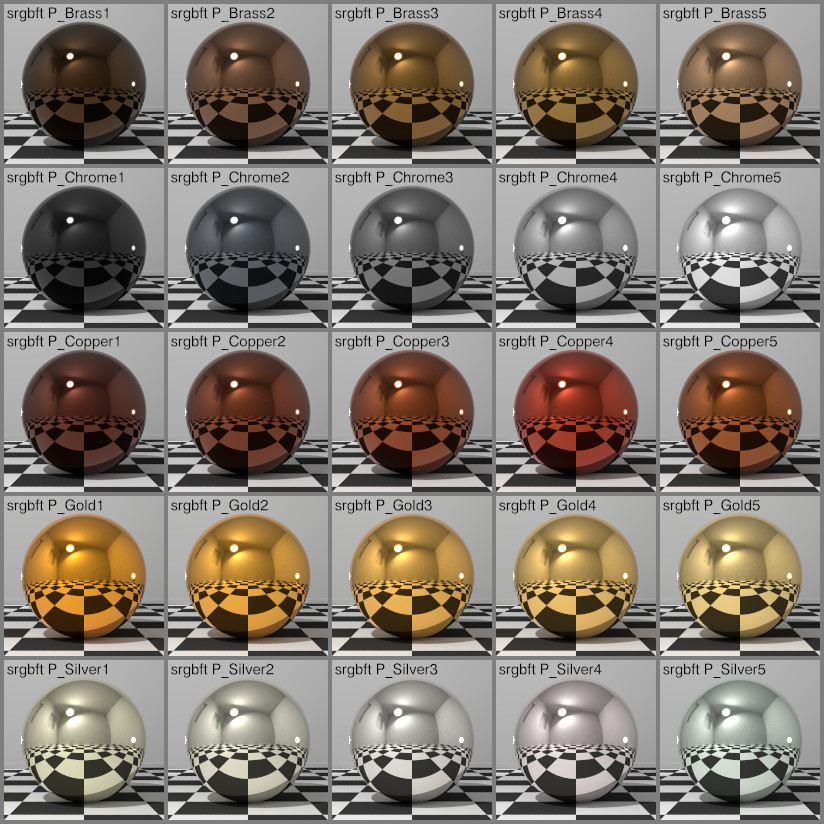

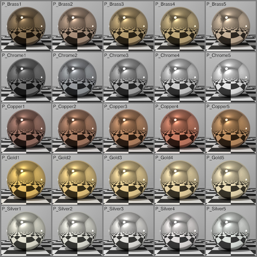

When Thomas de Groot challenged Alain and me to write improved
metals.inc, one of my first thoughts was "Why bother? It's a lost
cause."  Alain's solution was to just replace all the ambients with 0,
but I think that's too simplistic.  That file and golds.inc were written
before POV-Ray had metallic reflection.  File golds.inc goes through an
elaborate ritual to compensate for this deficiency, while metals.inc
ignores the problem completely.  Everything about those two files
screams "OBSOLETE!"  But the challenge still gnaws at me.
One question that must be answered is should we assume that the colors
are gamma pre-encoded?  Image stock_metal_gamma-srgb.jpg assumes that
they are, and uses the srgbft keyword to decode them.  Image
stock_metal_gamma-linear.jpg assumes they are not, and just uses the
colors as-is.  Comparing them, it seems to me that the colors were not
pre-encoded, unlike those in colors.inc.
Both images use assumed_gamma 1, and the spheres use this finish:
  finish
  { ambient 0 diffuse 0
    reflection { 1 metallic }
    specular albedo 1 metallic
    roughness 1 / 3000
Of course, any improvements to these files will cause old scenes to look
different.  Better, but different.
Download 'stock_metal_gamma-srgb.jpg' (220 KB) Download 'stock_metal_gamma-linear.jpg' (209 KB)
Preview of image 'stock_metal_gamma-srgb.jpg'
Preview of image 'stock_metal_gamma-linear.jpg'

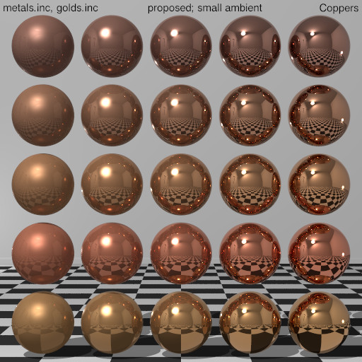

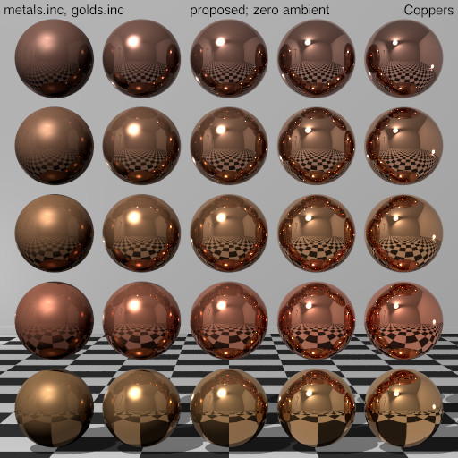

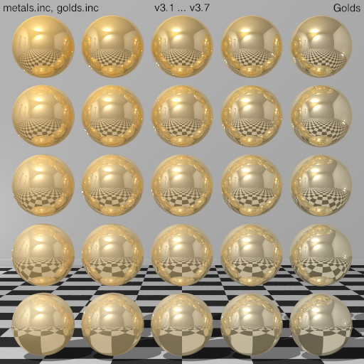

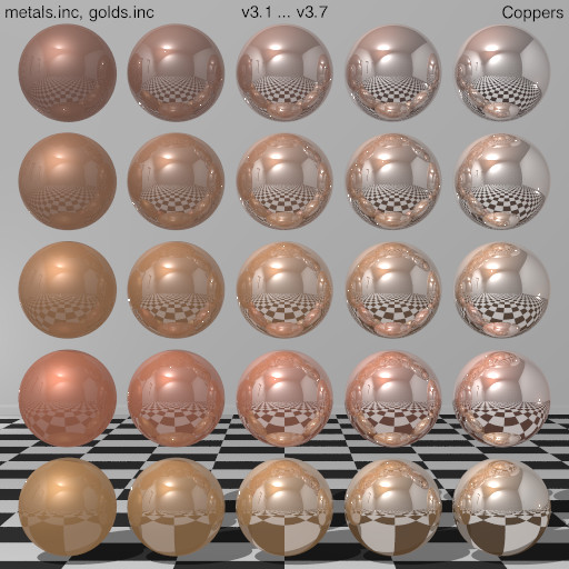

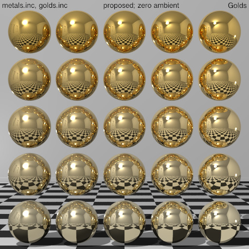

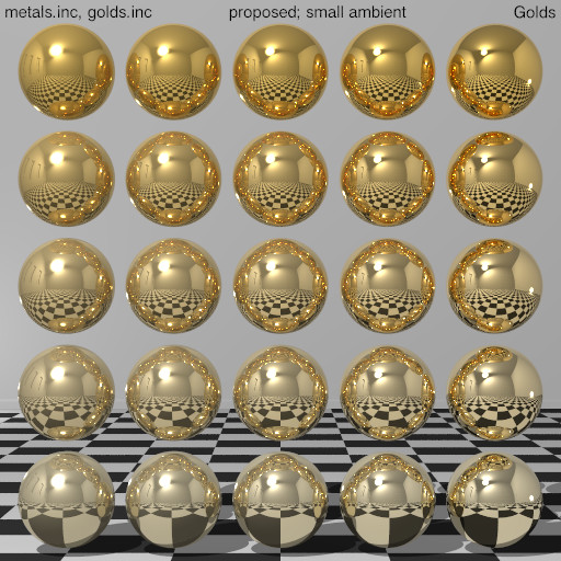

From: Cousin Ricky
Subject: Re: Colors from golds.inc and metals.inc
Date: 23 Feb 2022 18:31:30
Message: <6216c3d2@news.povray.org>
On 2022-02-22 11:48 (-4), Thomas de Groot wrote:
> Op 22-2-2022 om 14:36 schreef Cousin Ricky:
> I truly appreciate your thoughts and efforts. To address your last
> comment: I am increasingly convinced that trying at all costs to find
> solutions, at the same time preserving the aspect of old scenes, is a
> dead end. I would strongly be in favour of making those textures up to
> date, whatever the costs.
Heard, loud and clear.  Plus, I went back and rendered the old metal
textures, and I don't think they will be missed.  The portfolio scenes
don't give a realistic impression of how hideous they are.

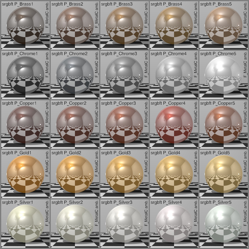

The ambients all default to zero, but for maximum flexibility, the
revised include files retain a provision for a small ambient.  I
included this provision due to my experiments last November.

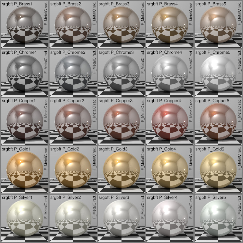

All these images were rendered without radiosity, because with radiosity
in POV-Ray 3.8, the ambient issue becomes moot.  But as I wrote in the
OP, the high ambient values are not the only problem with the textures
as they have been.
If you all like these, I will post the revised include files to p.b.s-f
(and also figure out how to do branches and pull requests).
Download 'metals31inc2.jpg' (90 KB) Download 'metals38inc02.jpg' (105 KB) Download 'metals38inc07.jpg' (101 KB) Download 'metals31inc5.jpg' (92 KB) Download 'metals38inc05.jpg' (125 KB) Download 'metals38inc10.jpg' (121 KB)
Preview of image 'metals31inc2.jpg'
Preview of image 'metals38inc02.jpg'
Preview of image 'metals38inc07.jpg'
Preview of image 'metals31inc5.jpg'
Preview of image 'metals38inc05.jpg'
Preview of image 'metals38inc10.jpg'
Date: 24 Feb 2022 02:14:39
Message: <6217305f$1@news.povray.org>
Op 24/02/2022 om 00:31 schreef Cousin Ricky:
Perfect!
I vote for the addition of a small ambient.
I discovered that the demo scenes from POV-Ray 3.0 explicitly set
assumed_gamma to 2.2, suggesting that the pigment colors were gamma
pre-encoded.  However, as the first OP image shows, this results in
metals that are too dark when used with a realistic finish.  It appears
that the old finishes exaggerated the luminances of the colors while
reducing their saturations, so it seems best to leave the colors as-is,
as if they were not pre-encoded.
Not gamma-decoding the colors does result in hue drift, but I think the
drift is in a better direction.
The attached images show the old finishes without and with radiosity.
Since they were rendered with POV-Ray 3.7, the ambients were
automatically suppressed for the radiosity renders.  The radiosity image
shows that the ambients were not the only problem with the old finishes;
the reflection { metallic } introduced in POV-Ray 3.5 really makes a
difference.
Download 'stock_metalc_gamma-srgb-a.jpg' (211 KB) Download 'stock_metalc_gamma-srgb-r.jpg' (211 KB)
Preview of image 'stock_metalc_gamma-srgb-a.jpg'
Preview of image 'stock_metalc_gamma-srgb-r.jpg'
