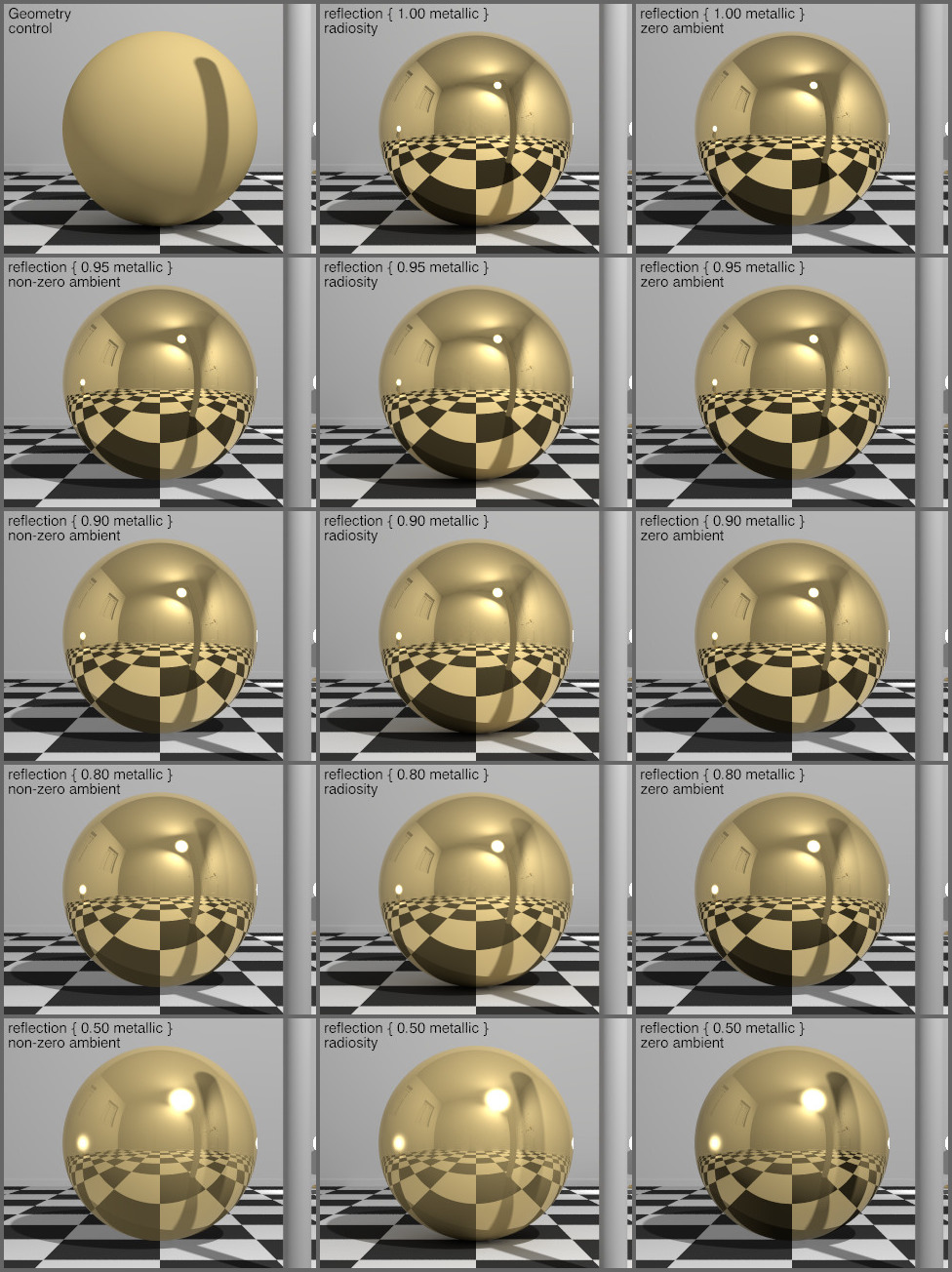

Image metal_ambient-pbi.jpg shows metal spheres with varying levels of
specular reflection, and a post used to cast a shadow on each sphere.
On each sphere, the 'diffuse' is calculated as half of what is not
specularly reflected.  For example, reflection { 1.00 metallic } has
diffuse 0, and reflection { 0.50 metallic } has diffuse 0.25.  The left
column sets ambient proportionately to the diffuse, and the right column
sets ambient to zero.  The middle column uses radiosity, and sets zero
ambient on all surfaces throughout the scene.
The radiosity cases are used as controls, to see how POV-Ray deals with
metallic surfaces with a diffuse component.  The shadows cast with
non-zero ambients (left) are better matches to the radiosity controls
than the shadows cast with zero ambients (right).  The same is true of
the reflected tiles.
(You may notice that the spheres also vary roughness with specular
reflection, but this is not at all relevant to the question of ambient &
diffuse.)

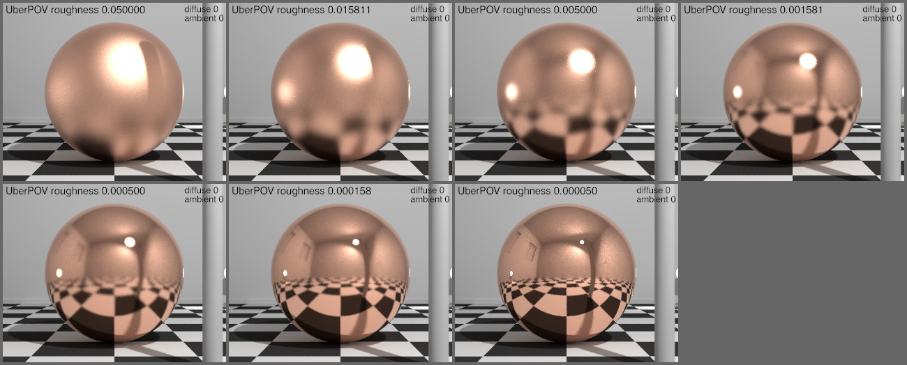

For completeness, I also decided to test whether cast shadows show up on
100% specular surfaces with blurred reflection.  Image
metal-blur-shade-pbi.jpg shows spheres with reflection { 1.00 metallic }
and varying levels of blurred reflection.  Cast shadows show only where
they interrupt the blurred highlight.  So, if POV-Ray's modeling is
accurate, this means that the dull metals I examined IRL should be
modeled with a small diffuse component--and per the previous test,
should have a correspondingly tiny ambient component.
Download 'metal_ambient-pbi.jpg' (340 KB) Download 'metal-blur-shade-pbi.jpg' (154 KB)
Preview of image 'metal_ambient-pbi.jpg'
Preview of image 'metal-blur-shade-pbi.jpg'

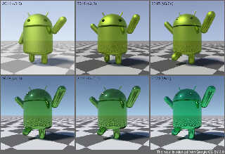

Download 'spec-androidrobot-pbi.jpg' (122 KB) Download 'spec-rc3metal-pbi.jpg' (118 KB) Download 'spec-roundedge-pbi.jpg' (111 KB)
Preview of image 'spec-androidrobot-pbi.jpg'
Preview of image 'spec-rc3metal-pbi.jpg'
Preview of image 'spec-roundedge-pbi.jpg'
