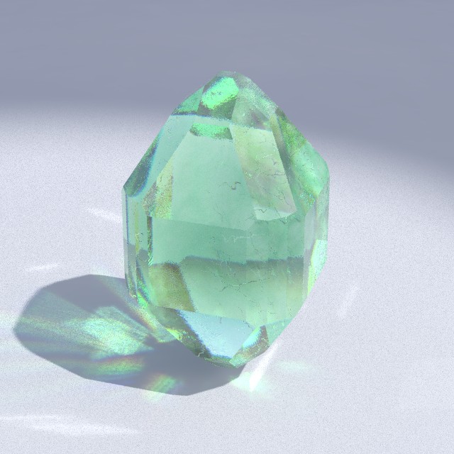

Continuing Sam's investigations on crystal shapes and materials, and
using KrystalShaper as the primary crystal builder.
This is a crystal of apophyllite. The coloured variety is
Fluorapophyllite-(K).
I based the material on the one given by Sam in the "Alum" post in
September last, including Alain's comments. I then added surface normals
from the crystal experiments by Jaime Vives Piqueres, as also a more
'cloudy' aspect using a bit of scattering media, and a density block.
Finally, I added photons. Possibly, the hue should be a tiny bit more
bluish-green...
The environment makes use of a hdri map and a spotlight. The render
makes use of a, non-optimal, stochastic setting, which explains the
grainy aspect. However, I am still experimenting.
Download 'krystalshaper_apophyllite_004d.jpg' (75 KB)
Preview of image 'krystalshaper_apophyllite_004d.jpg'
I'd like to see a cleaner render - without the really grainy stuff, and a nice
clean, smooth background.  But I like the crystal - it looks pretty cool.   Does
the software export vertice information?
Thinking that maybe any calculation runs can be saved to some sort of include
file.
-BW
The crystal is very realistic, and I agree with Bald Eagle, a different
background could increase this realism.
Another thing: the crystal is vertical and gives a strange feeling to be
unaffected by the gravity... have you thought of adding a rock or
something else as a base?
Paolo

Op 24/10/2021 om 23:04 schreef Bald Eagle:
The software exports a set of intersected planes (which are used here)
/and/ a set of unioned cylinders representing the ribs. Vertice info can
be derived from those last, obviously. I have not looked seriously at
that part of the code.
> file.
Oh yes indeed. A lot of streamlining can be made on the code. Not sure
if I want to go all that way though, but I shall post a scene file when
I have cleaned up the whole mess. For the time being I am content with
trying to obtain as 'realistic' a crystal as possible.

Op 25/10/2021 om 00:08 schreef Paolo Gibellini:
Jaime did that indeed (adding a rock) and I probably shall do the same,
possibly all posed on some dark velvet cloth...
> Paolo
I understand the image as a very nice technical demonstration of shaping
and texturing gems. A base would hide some of the caustics. I think I
will have a look into this issue. I played a bit with photons too.
Best regards
Michael

Op 25/10/2021 om 08:47 schreef MichaelJF:
>> different background could increase this realism.
>> be unaffected by the gravity... have you thought of adding a rock or
>> Paolo
Correct. My primary purpose was to demonstrate the crystal by itself,
without the - secondary - scene additions.
It is my understanding that part of the caustics would probably remain
visible on a supporting rock. Jaime's images show them iirc.
Hey Thomas, it looks good!
I agree with Bald Eagle that a cleaner render would be nice, but of course that
would drive up the render time, should you wish to increase the number of
samples. I mean, you're using scattering media + caustics, and we all know how
that goes.
How long did this take to render? The file name says 004d, so I really hope it
wasn't 4 days ':/
I'd like to discover a cheap and realistic way to add internal fractures to
mineral renders. Apophyllite is one of those minerals prone to being found in a
fractured state. I have two ideas in mind, but both are rather expensive: 1)
height fields intersecting not only each other, but also the crystal shape
(which is itself an intersection); or 2) isosurfaces. Both can be very, very
slow. Sometimes I wish media had an ior block.
Is there an online POV-Ray render farm anywhere? :P
