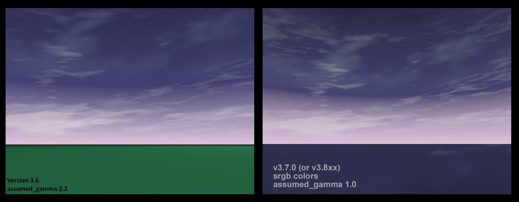

> I decided to try that myself, for the S_Cloud1 skysphere...
This is what the comparison was supposed to look like, between
v3.6 at assumed_gamma 2.2
and
v3.7.0 (or 3.8, same effect) at assumed gamma 1.0
There is a slight difference, perhaps in contrast. It is difficult to figure out
exactly what causes this; but it might be like comparing 'apples to oranges',
considering the many changes that have been made to POV-ray since v3.6.
Download 'skies_scene_comparison.jpg' (114 KB)
Preview of image 'skies_scene_comparison.jpg'
From: Mr
Subject: Re: Upgrading POV-Ray's include files - a few remarks
Date: 1 Mar 2021 08:45:08
Message: <web.603cef406dc18ced6adeaecb0@news.povray.org>
Thanks a lot or your undertaking,
First note that looking at images through small previews on the web interface of
theses newsgroups is always error prone and one would naturally go to the more
contrasted. But opening full screen and really looking at pictures,
I clearly prefer the third version because a) it's the most realistic would one
consider the season to be winter (paler) rather than summer, and b)that does not
show procedural cloud color map edges so contrasted as was so frequently done in
the nineties, it's crucial now that POV moves away from what people think are
its limitations to show what it really can do.
If not already done, could more "modern" macros such as lightsys or
CousinRicky's metal work or the ones you mentionned be integrated to those
official libraries at last or is there some show stopper ?
Date: 2 Mar 2021 02:52:43
Message: <603deecb@news.povray.org>
Op 01/03/2021 om 14:42 schreef Mr:
Aha! This again, addresses imo the fundamental question, also mentioned
by BaldEagle, if we should not take leave of (some) of the "backward
compatibility" rule. These cloud scenes were great a couple of decades
ago but hardly anyone nowadays would use them without serious changes;
even newbies would probably not find them acceptable given the
development in the field of cgi.
So, I think that POV-Ray's include files should reflect these changes
and, as Bald Eagle wrote too, provide a switching system to show, where
possible or available, the evolution of the concept. In the case of
clouds, that would mean these simple, version 3.1 and 3.5 cloud scenes,
and the version 3.7+ alternatives.
In other cases, upgrading will be much more straightforward imo.
Metallic or wood textures e.g. But there too, new additions might be or
should be seriously considered. After all, over the years, we have
acquired a huge amount of creative power condensation and deposition! :-)
